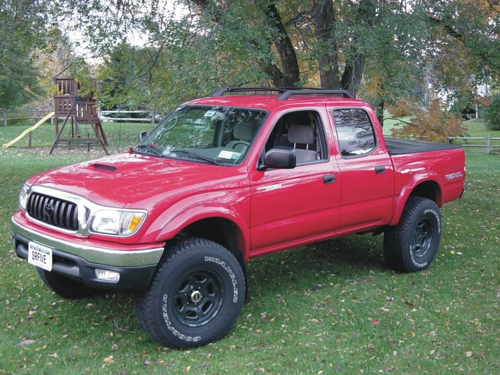

    Check out Fat Bob's Garage. Their kit comes with diff drop. I had their 2.5" w/o diff drop, but my truck wasn't level with the AAL I had, so I upgraded to their 3" spacer w/ diff drop. Couldn't be happier! (That's after returning my aftermarket coilovers).
