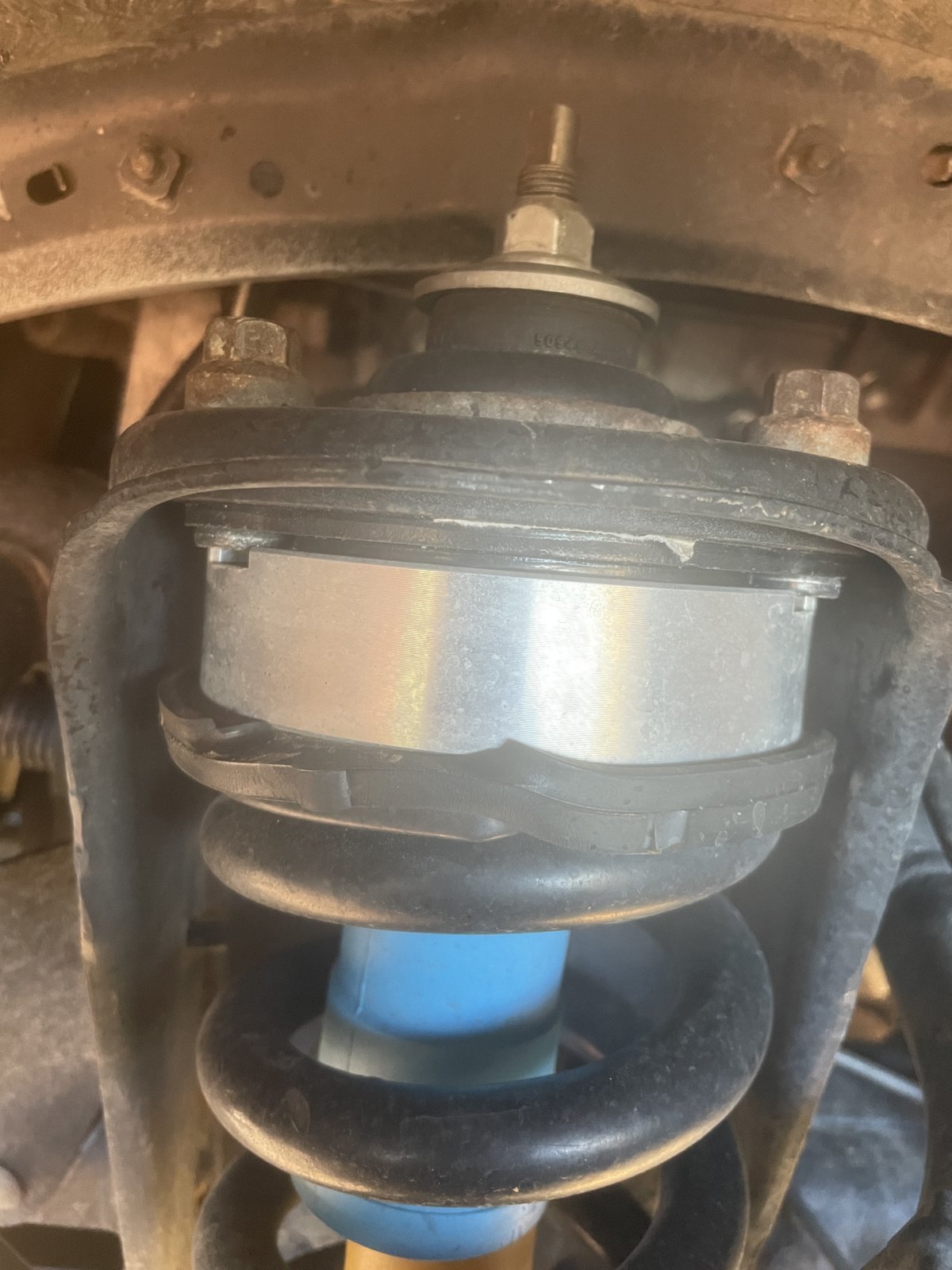

    IMG_1266.jpg My truck has two spacers up front and an aal in the rear, The largest front spacer measures 1 inch and the second one measures 1/4inch does this equate to 2.5 inches of lift. The spacers are on both sides

    Ya those are mega preload spacers, they tend to ride super rough. Typically you double the size of the spacer on the front to get the lift amount.

    Yes that’s what I’m experiencing I am planning to switch to billsten 5100s and ilbach 2.5 inch lift springs to get a better ride, and would like to maintain the same lift as the spacers.

    Typically the more you spend the better the ride will be. Consider 6112s or equivalents as well. 5100s ride ok with springs, but there is better, and combined with springs I'd be curious how it compares.

    Bigger, way better designed for offroading. 5100 is more of an OE replacement, 6112 is a better offroad shock, especially on gravel higher speeds.
    I really prefer the way the 6112 rides compared to 5100s with coils or eibachs.
    Figured I'd just suggest it, especially if the price is right.

    I had those big top block spacers. Hated them off-road.
    Rode like I had no suspension and rattled me off my seat on an easy FSR. Rode fine on pavement, but introduce any bump no thanks.
    I did eventually go with a 1/2in spacer but I eventually got rid of that too for a new coilover.
    plus the big blocks ruined the ball joints faster for some reason.

    If there is about 2.5 inches of lift up front would of be safe to assume that the previous owner did a 1.5 -2 inch AAl in the rear to level it ,there is a carrier bearing drop so I would assume there is a lift in the rear. There is no block.

    hard to say without photos of the leafpack. But that would make sense.
