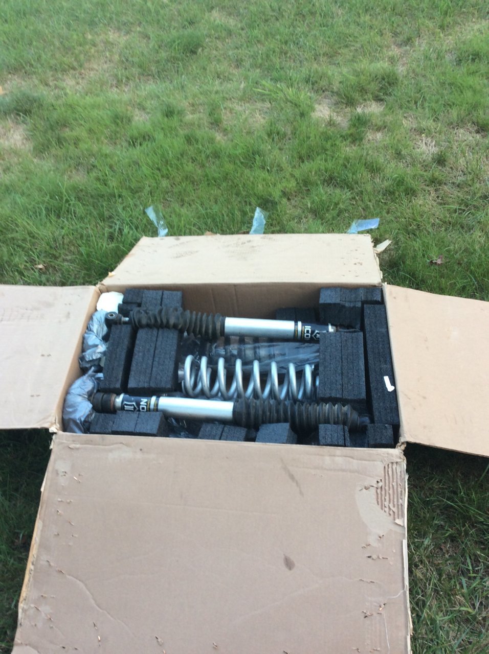

    go2cnavy
    go2cnavy Well-Known Member
    Sep 25, 2016
    #198172
    1,236
    ‘17 OR DCLB. VF Tuned, 5.29s, Dobinson’s MRR
    OVTuned w/ 5.29s 2” lift on Dobinson’s MRR paired with ICON RXT leaf packs. SCS RAY 10s Toyo Open Country AT III 285/70R17
    Not sure how your Ford Ranger is set up; but this is your typical Tacoma spacer lift. 2” up robs you of 2” of down travel I’d estimate that you might have 3/4” of down travel max after this lift. This was my truck from the factory. Removed it immediately and made them refund my money.
    Removing the sway bar is not required, but makes it a lot easier than removing tie rods or linkages.
    I’m not saying Icon, King, Fox for everyone. There are plenty of other Coilover setups for under $500 to achieve ride height ride without sacrificing ride quaility.
    If you can’t afford a real lift, don’t lift your $30K truck. And sure as hell don’t cut to fit 285’s with a spacer lift. I’d spend $1000 on suspension and rock 265s before I spent $100 on a spacer lift and $1000 on 285s + $$ wheels and hacked my truck up.
    BUT it’s the OPs truck and his choice. I’m just providing a solicited opinion.
    AND cheap alignments are cheap.
    I had these up for sale locally over the summer. I will post in the BST forum in a few weeks. $650 shipped anywhere in the continental USA
