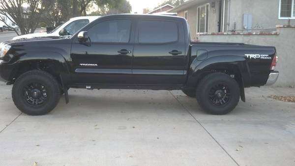

    Ok, I'm gonna start a fire right now...I don't know why everyone is so against spacers. I put a 3" spacer in the front and a 1" block in the back. As far as how rough it is??? It's just like stock. I will, however, mention that i will be replacing the upper control arms.
    oh man...afraid to even hit post!!

    I should clarify that I will not be flying off any jumps.[​IMG]
