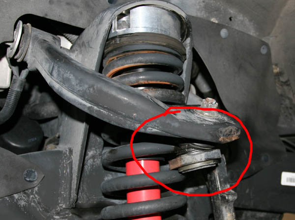

    On top of the coil assembly??
    Although, its been a very long time since I used to work on 1st gens...
    Putting too much spacer ontop (or outside of the coil assembly) will put your steering knuckle too close to the coil assembly.
    Searching the internet - and this is the best photo I can find that might explain it.

    That's why they have aftermarket uca to correct that problem
