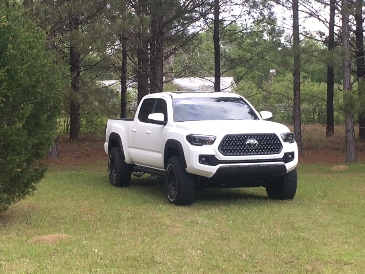

    B16DBA26-C7F8-4FB1-AA7C-33391144E9D9.jpg Mine is ome 884’s on 5100’s 0 setting. One inch up front.

    Great looking truck! The storm trooper is strong.
