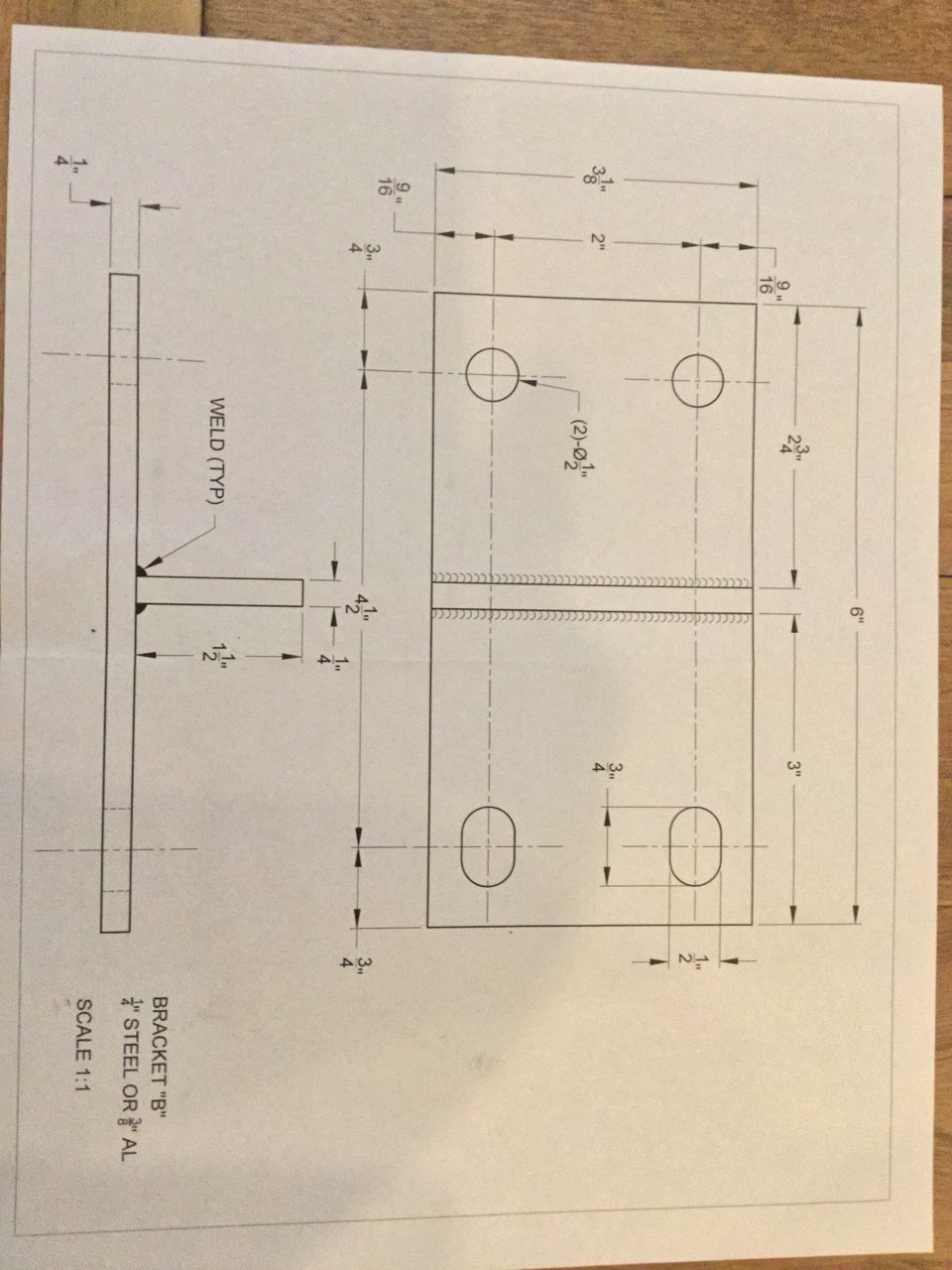

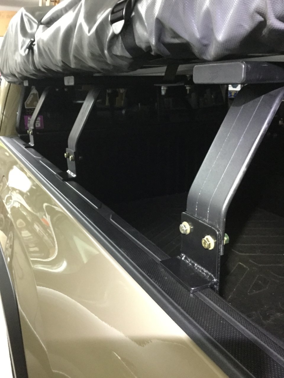

    Yup, had these made.
    791A0AD5-409D-4397-BCA9-FE449204D739.jpg 9EED006C-9D2F-4780-B474-1DFE7215354B.jpg

    This is a great idea. How'd it work? Looks better then my plan.

    They work great. Cost was $80 at a local fab shop, you can take my drawing to any metal fab shop for a quote. I painted them myself but if you want to get fancy you could have them powder coated.
