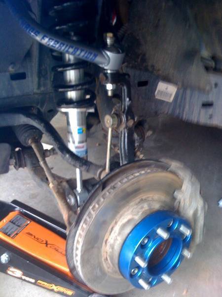

    Here is a picture.
    Its the blue circle thing incase you are not familair with wheel spacers.
