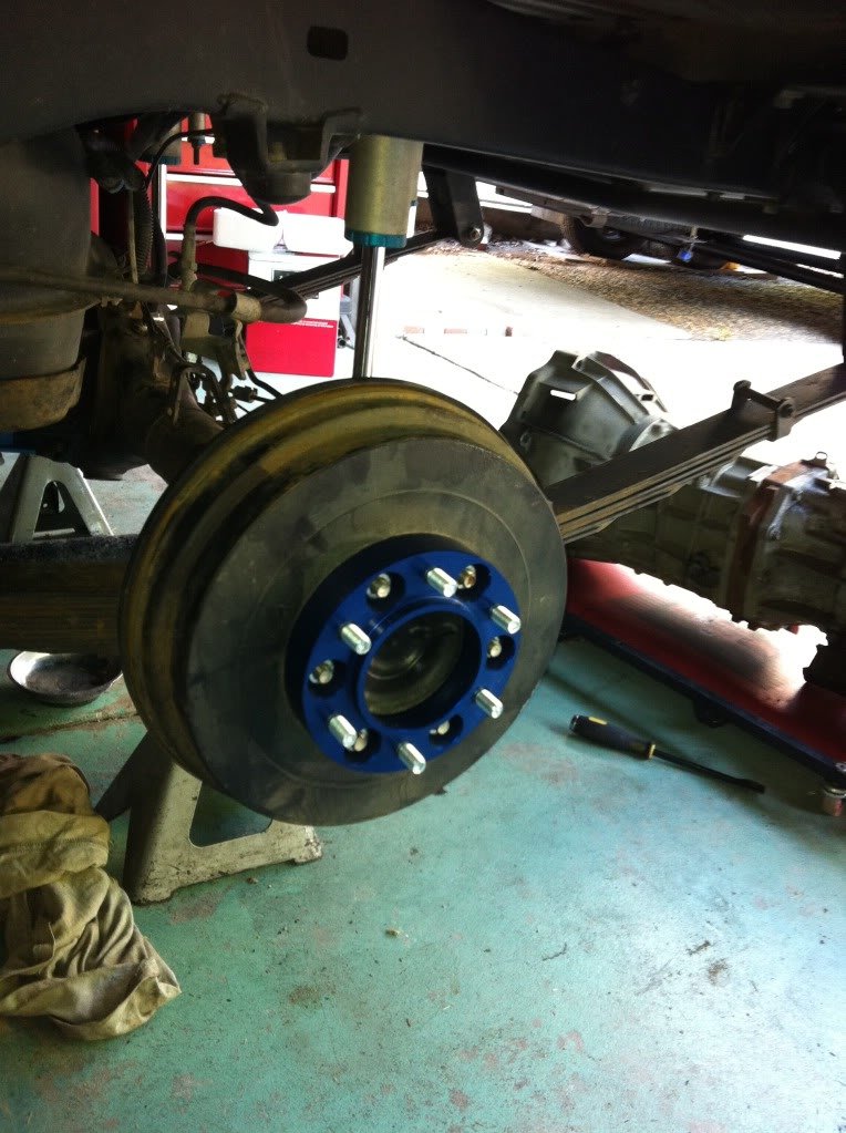

    Who's running them? Any issues with them not withstanding hard wheeling?
    I'm thinking of running some 1.5'' spacers on the rear axle to make the rear wheels track closer to the front wheels.

    I have been on mine for about a year. No issues thus far, just make sure you get Quality spacers.

    Just torque em down and apply some red thread locker

    this, make sure they are torqued to the specs it tells you and put the red locktight stuff(it usually comes with them) i have spidertrax in the front of my truck and i dont have any issues, spacer paranoia just gets to me and i end up pulling my wheels off and checking them every month or so

    I've got some All Pro 1.5" spacers in the rear..still doesn't even come close to matching the froggy front width..:D

    I got 'em in the back too... no long travel, but spindle lift widened my front by 3" so I used 1.5" spacers on each side in the back to even it out. No issues yet... but I am kinda leary of them (even WITH my "young and therefore invincible" status haha)
    They are aluminum though... so I figure if they're ready to break they'll start to bend first and cause some horribly wobbly wheels.

    I've got 2 inch ones from H&R and I have only put them on once. Perfect. A must have for LT trucks if you ask me.

    I'm running the spidertrax spacers on the rear. I beat the shit out of my truck and have had zero issues with the spacers.
    As everyone else says, red locktight and retorque them regularly.
