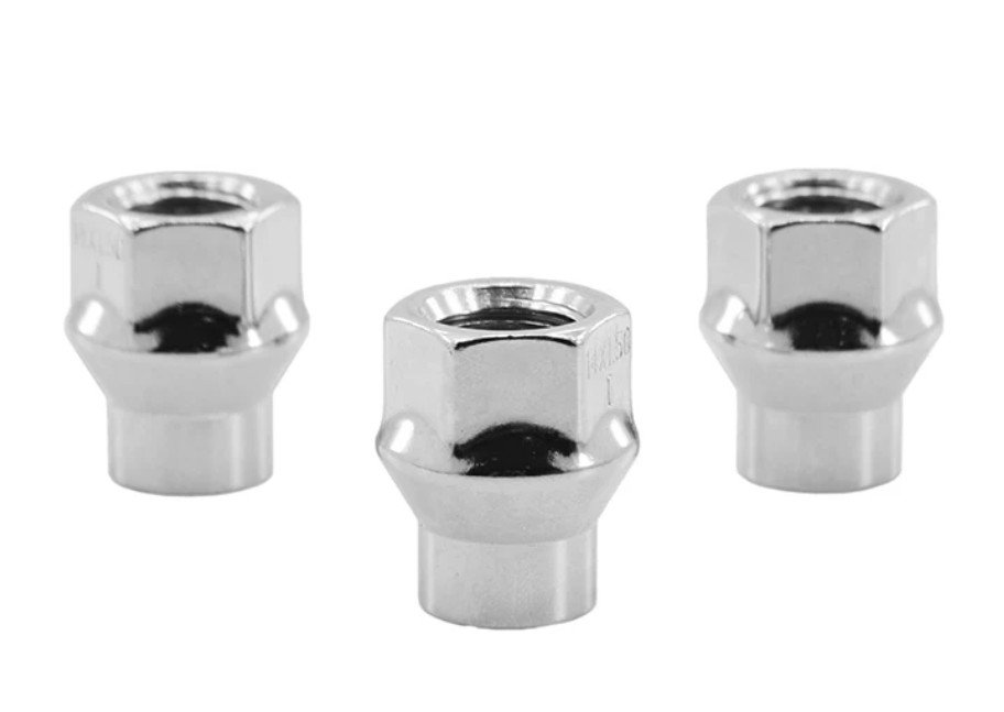

    Have you tried extended thread lug nuts yet?

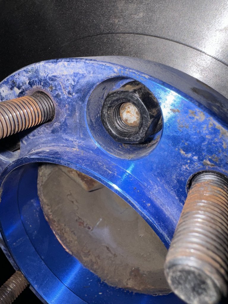

    Since you asked for opinions, I'll offer mine. A couple of thoughts here:
    - The spacers are definitely too thick for your wheel studs. The pics show that your studs are about 3 threads too short. Good practice is to have at least 2-3 threads showing past the lug nut. I would not be comfortable running spacers like that.

    Those are the lug nuts installed !

    if you installed those, how much thread would you say is through the lug nut 3/4"+???
    still looks sketchy as fuck!!!!
    did you actually torque them?
    send a pic, email, description, vehicle info to spacer manufacturer.....
    see what they say....

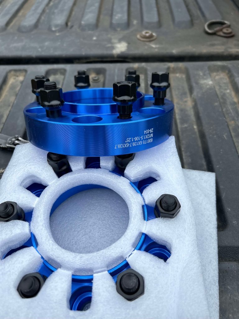

    Those lugs are meant for the OEM studs, not the studs on the spacer.

    looking at the pics, thats alot of thread thats being used vs 1/8"-1/4" thats not...
    Ide still send email, see what they say...
    If its a quality brand spacer, they've seen every scenario....
    vs rolling the dice & possible bad outcome
  11. Feb 2, 2025 at 8:09 AM
    slater
    slater Well-Known Member
    Apr 16, 2024
    #448066
    2,407
    San Diego
    24 white Tacoma TRD Sport 2wd
    thats what he said he did, pay attention...:D
    but yes thats not what you see in just the spacer pic off the truck..

    yep the extended lug nuts are installed on the oem studs

    Why I mentioned it.

    Wrong. Supplied nuts go on the spacer, stock nuts on the wheel.
    edit: I think I may be arguing with you...carry on...:anonymous:

    OP, provided the spacers are tight to the brake rotor, and the nuts are threaded all of the way through, you should be OK. The studs not going through the nuts is concerning, but with fully threaded nuts, you have enough threads for a solid mount.
