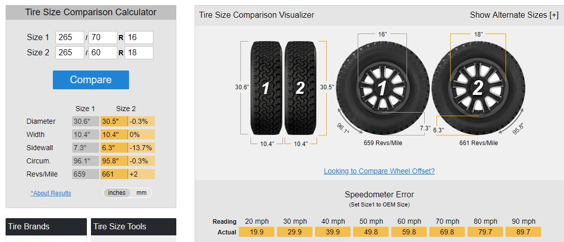

    So who here has a Gen3 with spacers while still running the stock suspension and stock wheels & tires?
    Do you have any rubbing issues with the spacers?

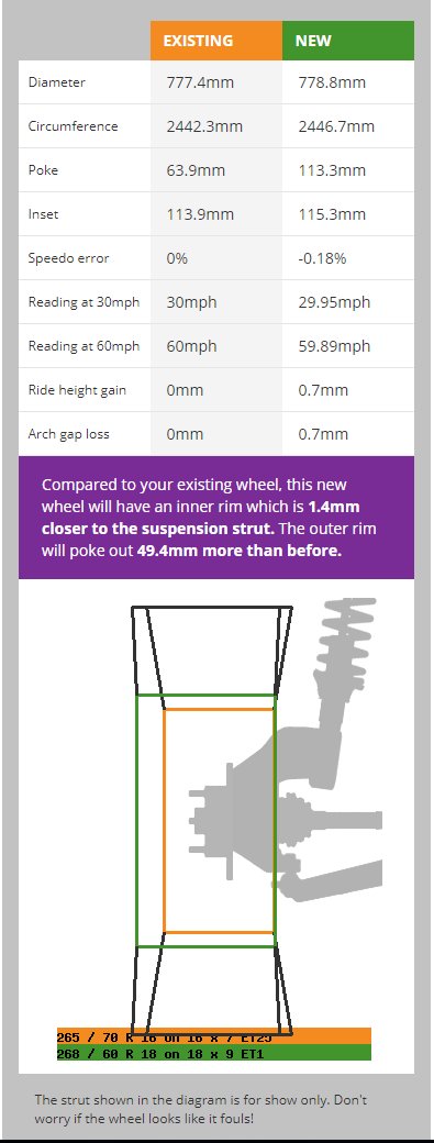

    I’m interested in a wheel that has a 1mm offset; my stock Off-Road wheels have a 25mm offset. So that should be roughly the equivalent of a 1” spacer, no?
    I’d be keeping with the stock tire width, 265, on the new wheels.
    Trying to determine what will fit without necessitating any trimming or cutting of the frame.
    I would *think* anyone who’s running a 1” (or larger) spacer without rubbing would net me the same result.
    For reference:
    Stock wheels and tires = 16x7 ET25 with 265/70-16 tires.
    What I’d like to install = 18x9 ET1 with 265/60-18 tires.
    Thx.

    so I switched from 265 65 17x7.5 et 30 to 265 70 17x8 et 0 and had some rub in the middle of my front OEM mudflaps. So I took them off (the mudflaps). But that was also a 1" difference in height of the tire.
    Edit to add, yes, the offset is just about equivalent to a 1" spacer. You will probably be just fine.
