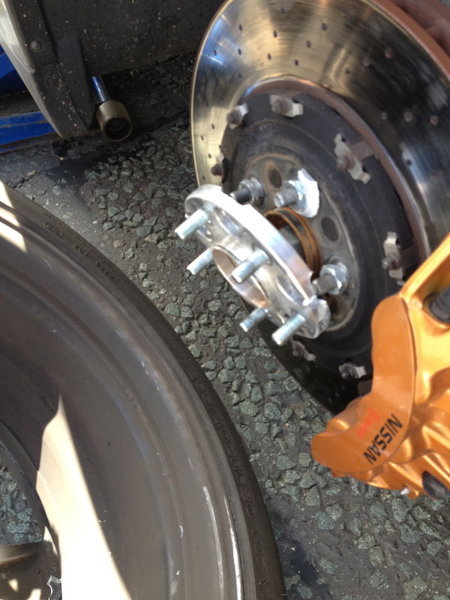

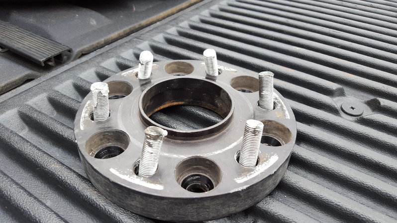

    Looks like someone doesn't know how to install wheel spacers.
    I can find pictures of destroyed wheels due to loose lug nuts too. And cheap wheels. Does that mean people shouldn't use wheels?

    Ouch!! Was that ur truck?

    No but there are plenty more photos where that came from.
