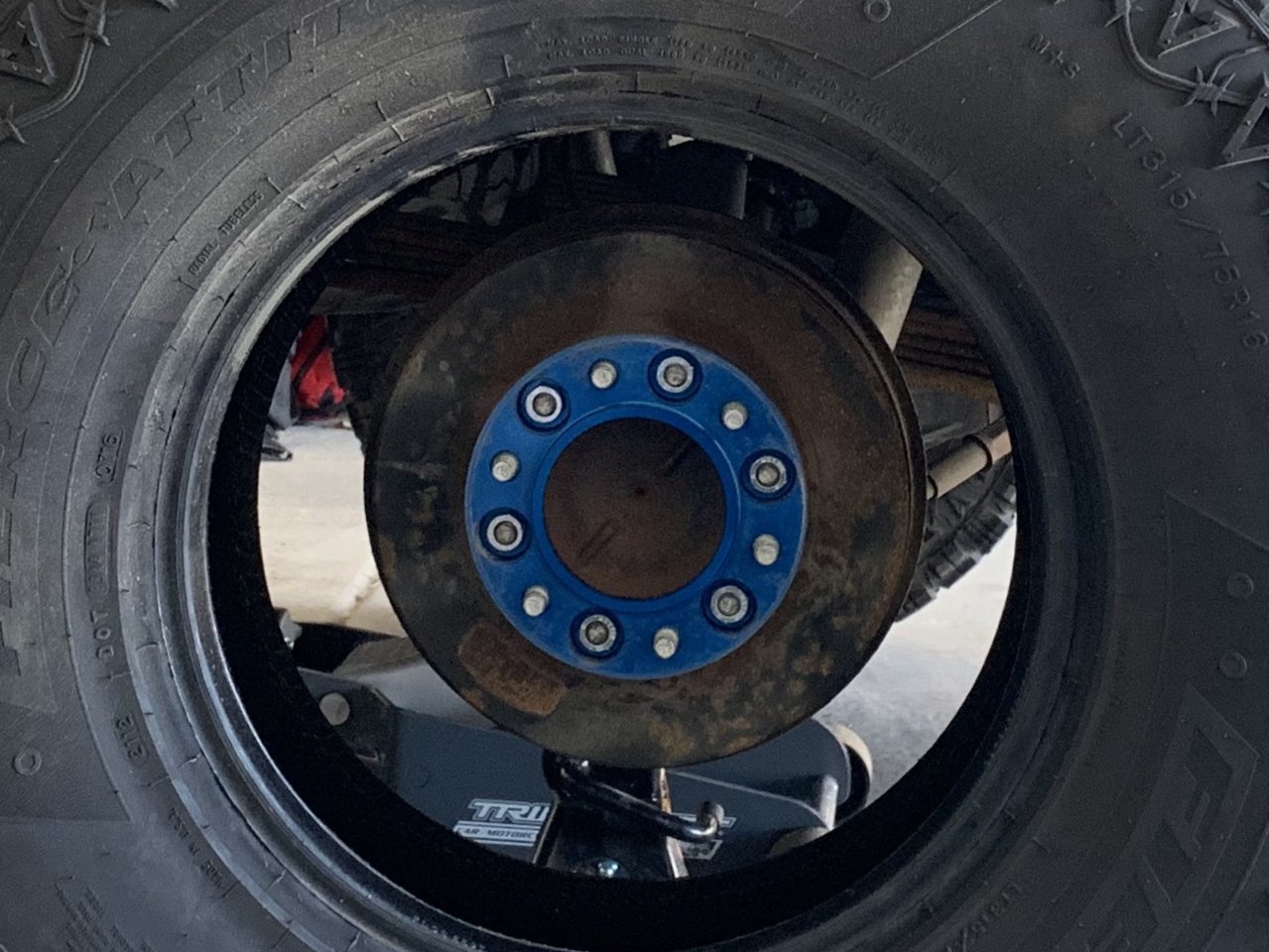

    download.jpeg.jpg The spacers lug openings are tapered and the nuts are acorn shaped. Should be a non issue with the threads.

    I think there is some confusion in the confusion. @Wattapunk is correct.
    To clarify let’s go over everything. Spridertrax 1.25” spacers are not the cheap 1/4” spacers that simply fit between the hub and the wheel.
    Spidertrax 1.25” bolt on to your existing studs using the hardware it came with. The Tacoma studs are more than enough as the lug nuts that came with the spacers will completely engage with room to spare. The entire lug nut and all of its threads will be engaged and you will see some of the stud sticking out of the top of the nut.
    From there the bigger issue is the aftermarket wheels and their accompanying lug nuts engaging the spidertrax studs. While the spidertrax studs are roughly the same length as the Tacoma’s, most aftermarket wheels only allow 4-5 threads of engagement. You have 2 options, replace the studs on the spacers for something longer, or get ET lug nuts.

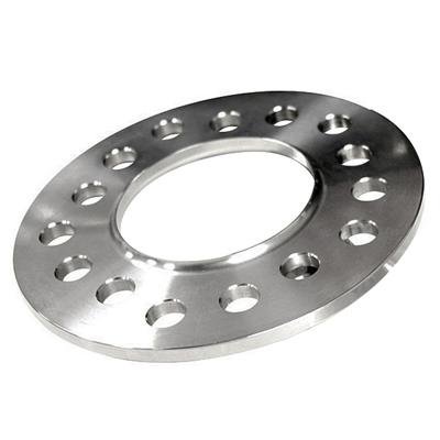

    OP, are you confusing the spidertrax with these spacers?

    No no I’m not confused I definitely don’t want the plate style lol. Last time I had spacers on my Tacoma (1.5”) I took them off because I needed to get longer studs. The reason being was the main studs only went into half of the lug nut.
