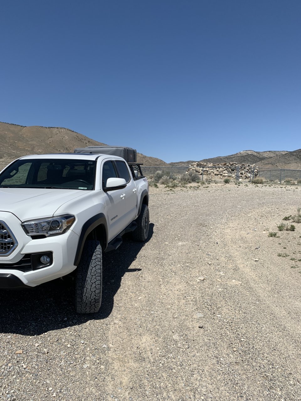

    I have 285s and 2” BORA bolt-on, hub-centric spacers on. Gives it a nice stance, and the tire tread lines up just about perfect with the OR fender trim.

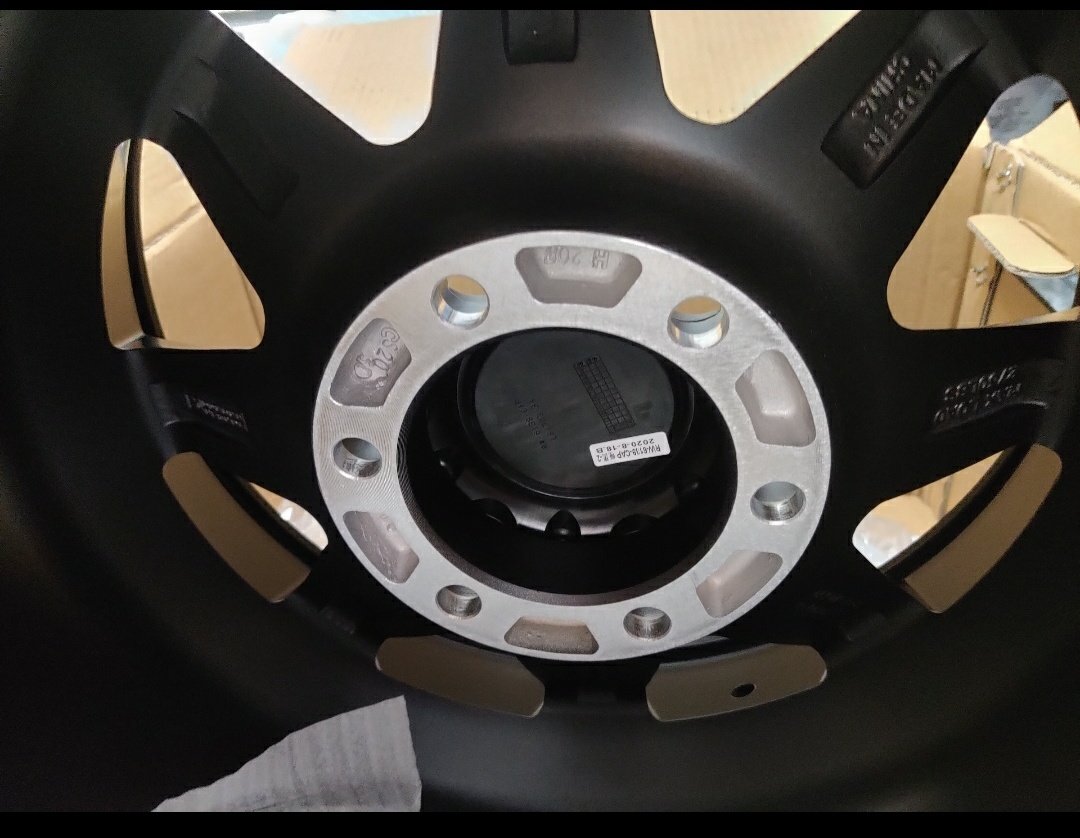

    If running 1.25", you'll likely rub a lot depending on wheel offset, caster(alignment), and if CMC.
    I'm on .75" Bora spacers. Your wheels will need cuts or grooves in the back b/c the studs are slightly longer than the .75" spacers.
