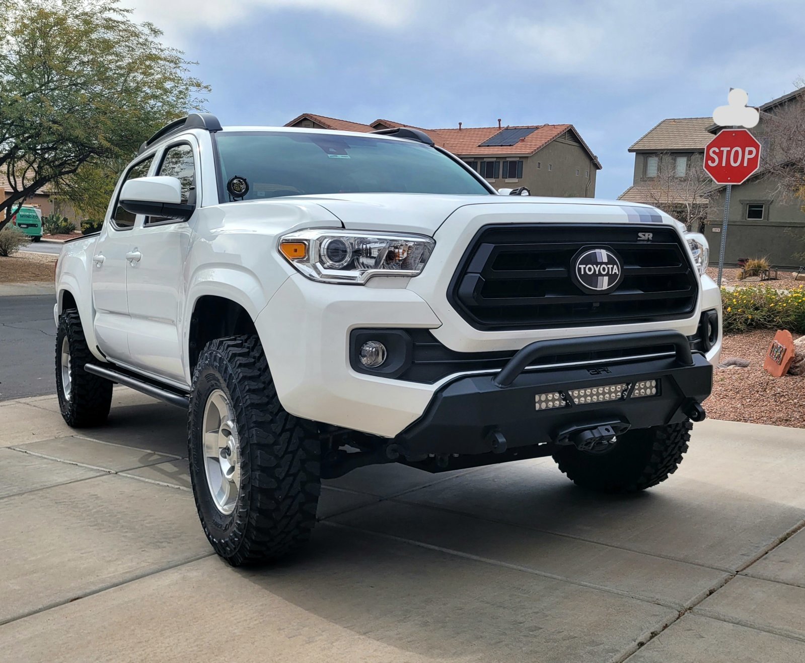

    1.25" spacers with pressed in wheel lugs, hub centric. Zero issues, 3 years of on and off road.

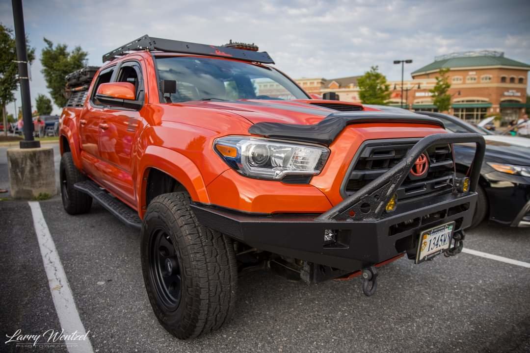

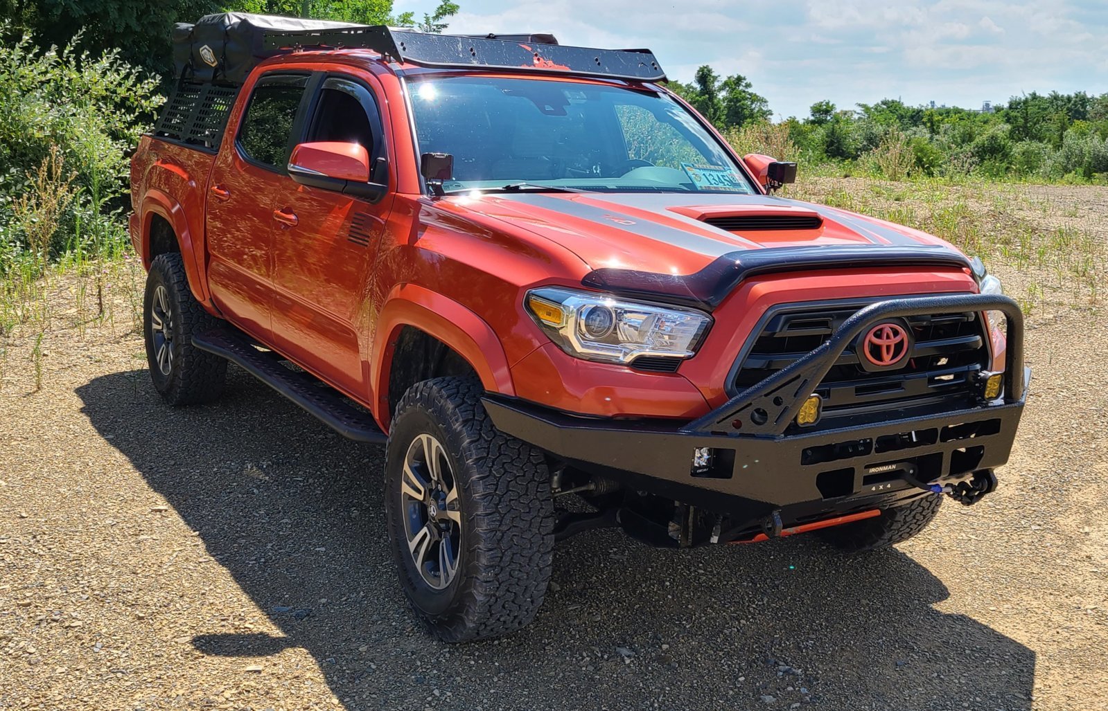

    Get the 1.25" spacers. I ran them on stock and 265/70/17 without issue for about 50K miles, on and off road. I had them before the three inch lift. With the lift, I'm running the same size tire on a 17x9 -12 offset wheel, no spacer, same stance. 126K on the truck and no issues with the bearings or the alignment.
    Stock wheels with 265/70/17 KO2's with 1.25 spacers comes .25" past the fender flare. Needed the spacers to clear the UCA's.
    265/70/17's on 17x9 -12 offset, same tire position without spacers on Bridgestone Dueler Revo 3's. (Now running the KO2's full time on the black wheels.) It's a good look (I think) and does well on the trails.

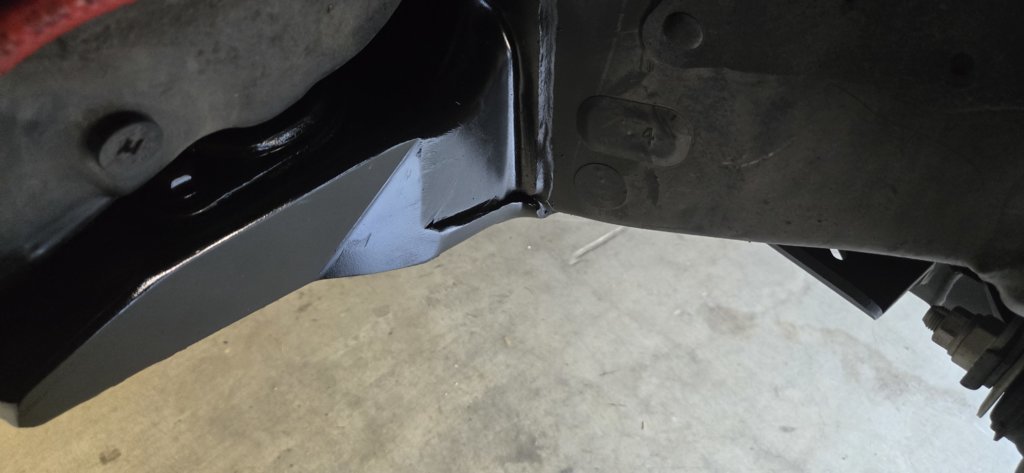

    I'm running OME 886 springs in the front and RXT leaf packs in the back. No rubbing until I went with a different wheel. Then I had a body mount chop done.

    I see now. You upgraded your wheels and tires and had to do a cmc. Got it.
