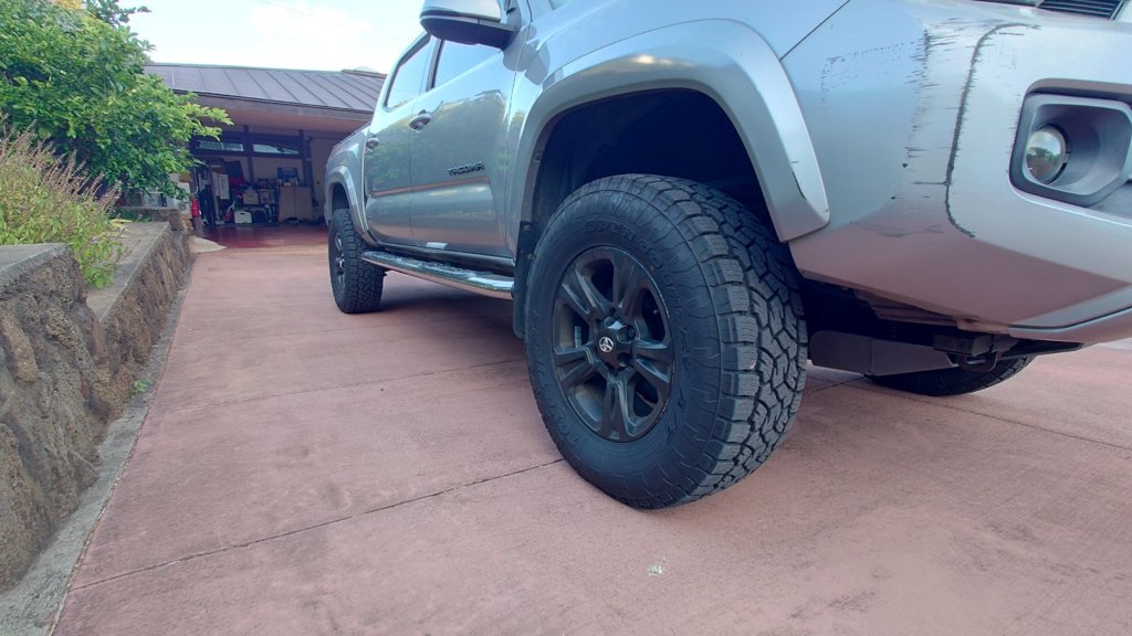

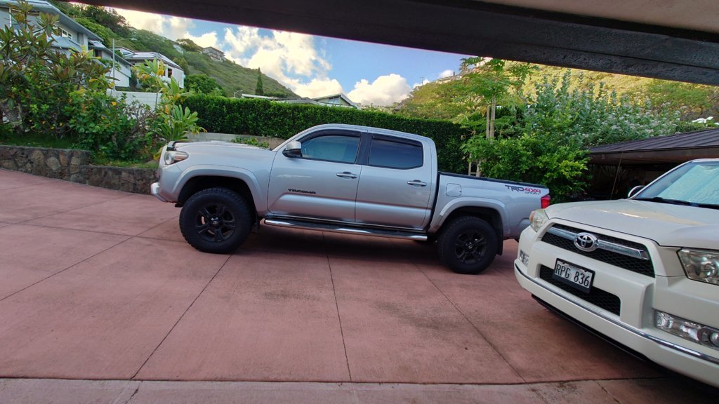

    VF Tuned ADM DS18 Tweeter swap Hella H9 headlamps Xenon Depot LED Headlamps in highs Morimoto LED Fog Replacements LED interior lights and plate lights Replaced all Toyota speakers with coaxials Meso Total Tails Stage I Plasti-Dipped rims, grille, emblems, and drink holder chrome. AVS window rims and wind deflector Toyota 2-Fold Truck Lid Spidertrax 1.25" spacers (black) Pool Noodle mod Rick's knurled delrin 6M shift knob
    265/70 r17 on Sport rims with Spidertrax 1.25" spacers.
    I've been running the spacers for more than a year but recently up sized tires to 265/70 from 265/65 stock size.
    I like the squat that the wider track gives, but I do grind my passenger side tires against curbs more than before without spacers.
    Like others mentioned, check torque every rotation and I have no worries...
