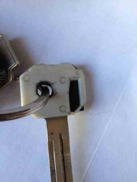

    Here is what inside "chip key" looks like.
    Dog ate the rubber off when she was a puppy

    awesome! i'm seeing it for first time now, thanks
