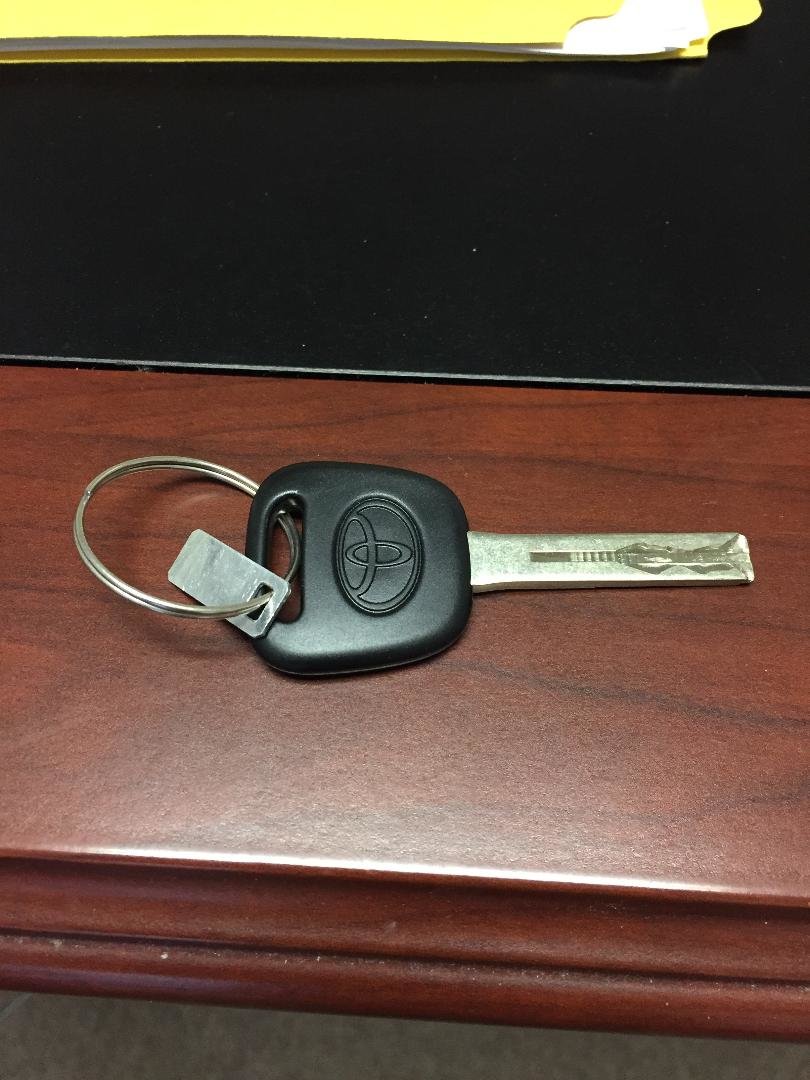

    this is what I have, plus the 2 key fobs with keys in them, this key here pictured only works on the driver door, glove box and tailgate, it will not start the truck, the dash display says use the key to push the start button but it does nothing

    All models without smart key use typical external cut keys and the same key works for everything (door, glovebox, ignition, tailgate).
    2016 models with smart key have an inverted cut key in the smart key which works in the door and glovebox with a separate external cut key for the tailgate. Ignition is electronic push-button only.
    2017-2019 models with smart key have an inverted cut key in the smart key which works for everything excluding ignition (door, glovebox, tailgate) and a spare inverted cut key which also works for everything excluding ignition. Ignition is electronic push-button only.

    I figured that out. so if I loose the fob I am screwed no way to start the truck

    Just like losing your key for any car.

    I have a MT so no push button start. I had a locksmith cut me a key that mechanically works the driver door, glove box, tailgate but not ignition for $6Cdn. I also got a spare key that in addition to above, has the electronics to operate the ignition for $105Cdn but it has no ability to remotely lock or unlock the truck doors....just another great reason to own a MT.
