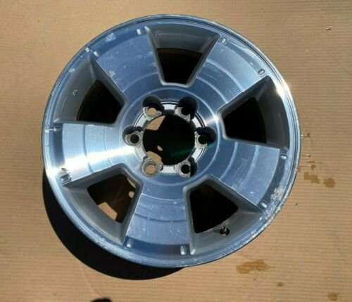

    So I have a 2017 with Bilstein 5100s and 285/70/17 BFGs on TRD SEMA wheels. My wheels push the stance out a little bit and I have no rubbing issues. I recently bought a 5th 285 and a 5 spoke (real thick spokes) wheel from a 4th Gen 4R to use as a spare. Will that wheel work on the front without rubbing anything? Anyone have experience with those wheels on a 3rd Gen? 034R Wheel.jpg
    This is the wheel I'm talking about...
    Thanks, Dan.

    I am wondering if it will work on the truck, specifically on the front, without rubbing.

    Im pretty sure that rim is like a +35 offsett. I had them on my 2015 on my trd sport. Def need a wheel spacer in the front to prevent rubbing the uca with a 285

    Thank you very much! That's what I was worried about.
