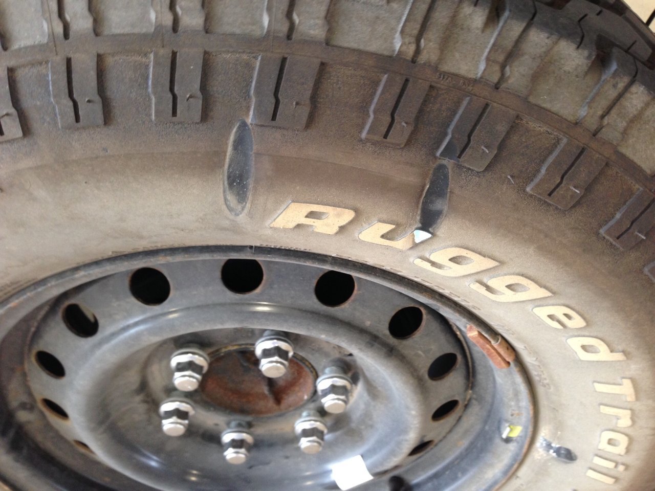

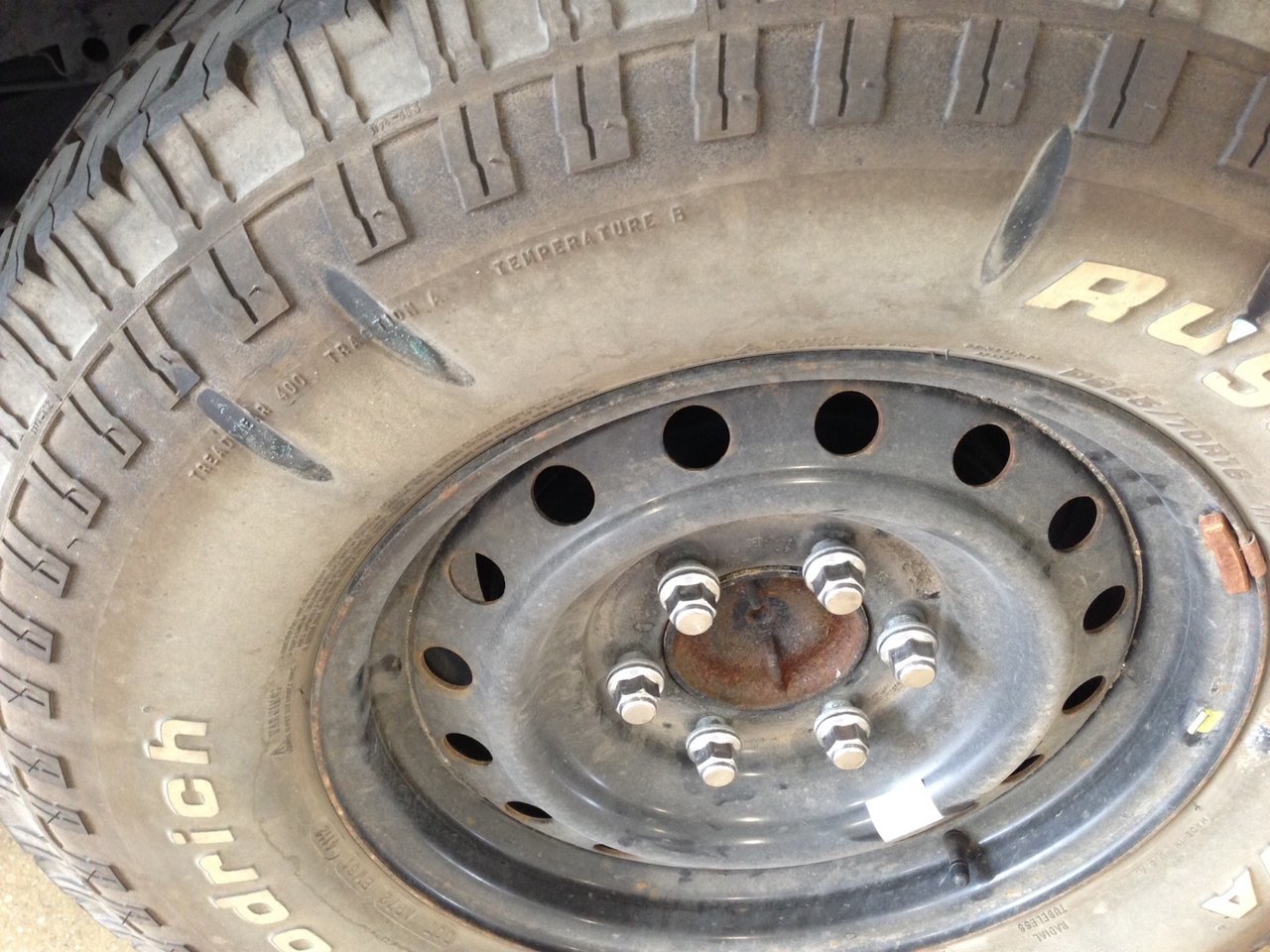

    I recently had to use my spare, only to learn that the way it was seated underneath the bed of the truck that the sidewall of the tire had been severely damaged. It looks like the frame rubs directly onto the sidewall in eight places. I would think there would be some type of rubber stoppers to keep the frame from rubbing through the sidewall. Needless to say, the spare did not have any air in it. The Toyota dealership insists that the tire is still good. Any recommended fixes so I don't ruin the next spare? Anyone else encounter this issue?849e71161e66cebcc69a42eeb53229db_d69f91c54ed774c8837920628cb0a2861e8b3db3.jpg6e249d9888c211d25fbce656980bdc82_21594b8d0d7b00fb563f8db3dba61654abd67f09.jpg25c83f07276a86b371178ab3707b5c1b_07d8322483e6a0f9848bdff8c196d05b99c89a7d.jpgb49671e31431ff499eca6e7c4e6725c7_8926c5fc4f9522f02ecad99890285cd5dccbb616.jpg

    It's only a 2013...not even 20k miles. Not even used off road. How can this not be a defect?

    I pulled my spare to replace a damaged tire so I didn't have to buy a new one and it had these marks. They go away.
    If it was wearing away rubber the white lettering would be worn through.

    In two places the rubs were more than rubs. Looks like it was down to the belt. The pictures didn't really show it very well. The air does not stay in the tire.

    It doesn't take tremendous crank pressure to hold it in place, and it's not pushing against the frame. It's seated in a designed X cross member with rounded edges. Put some rubber shims between the contact points and the tire if you're worried about it. For instance, cut 4 - 4"X6" pieces from an old bed mat and zip tie them in place. Check air pressure at least once a month, reset TPMS and you have it.
