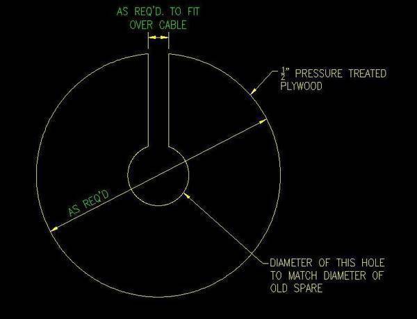

    I got a temporary fix for ya...gimme one sec
  6. Dec 20, 2011 at 1:12 PM
    Toyotacrawler
    Toyotacrawler She's got the jimmy legs
    Aug 19, 2010
    #41911
    11,603
    Cusseta/Opelika AL
    2010 Tacoma DC TRD Sport
    5100's set to 1.75" Wheelers 3 leaf progressive AAL & 5100's for the rear Konig Countersteer Offroads K&N Drop in WeatherTech's Bed Mat Blacked out Badges Rear leaf TSB
    This might work for a temporary fix. Somebody else on here might have a better idea or might have run into the same problem your having.
    Can you take of pic of the issue?

    If I understand this question correctly, the piece of metal at the end of the cable for the spare tire holder is too small for the new spare wheel. Yes??
    Remove the original piece of metal and install one that will be of the correct length to hold your new spare wheel.
    Good luck.

    all...i am going to work on this over xmas break with the family...we will rig something up...
    the spare is now the same size as the other 4 tires...and yes, the metal piece isn't large enough for the new center hole of the new spare..

    Good job thinking of this. This would be a good alternative to making a replacement piece of metal for the end of the cable.
