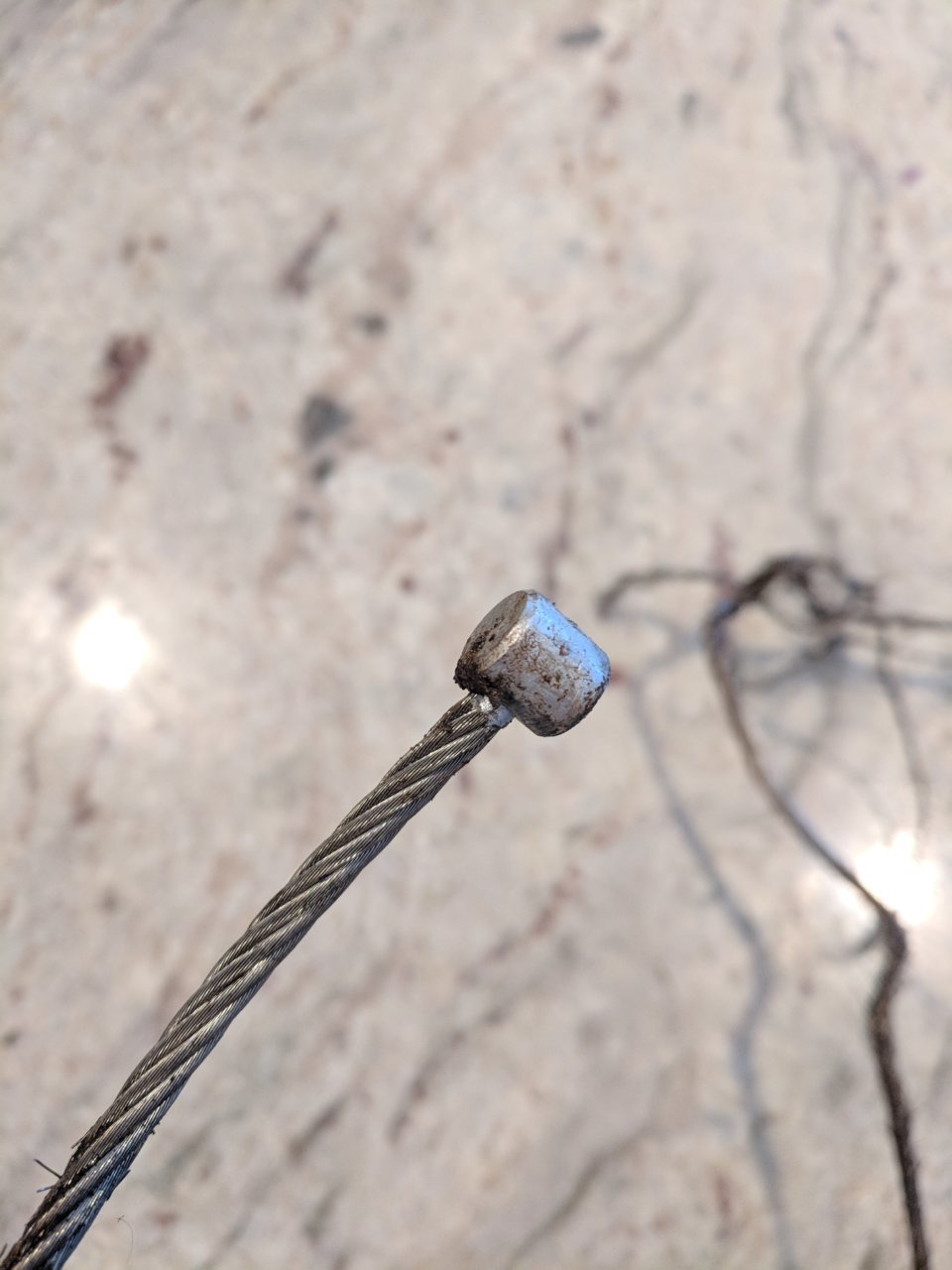

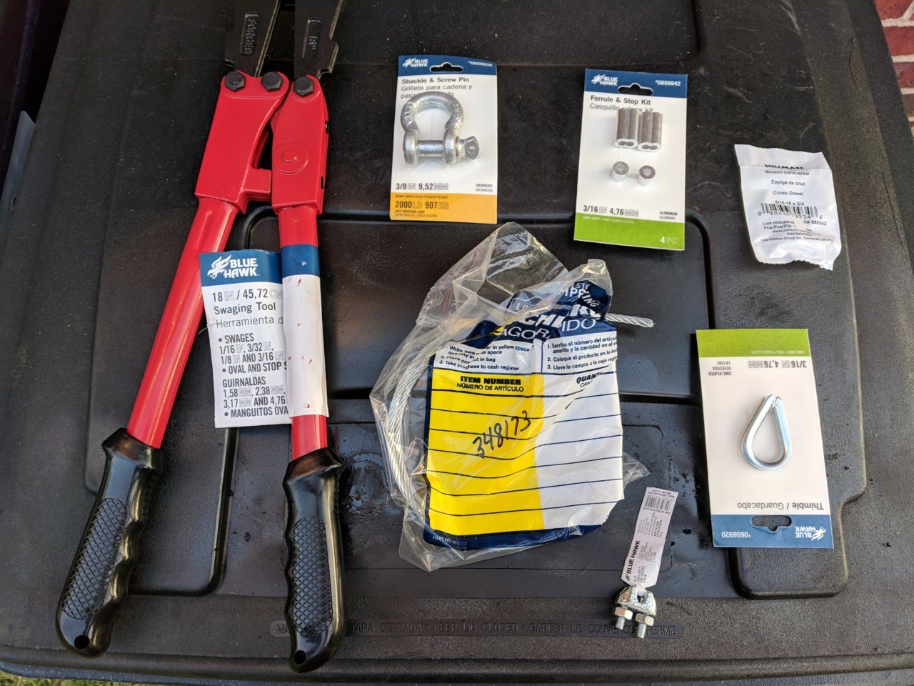

    This message is for anyone with a rusted cable searching for a solution in the future.
    Turns out you can replace the cable alone. I have the same system on my 4runner.
    If your winch is working its not too bad of a job. If its not working, spray the hell out of it with white lithium grease and try again the next day. It should move some. If not, get a cutoff tool and some safety glasses.
    Cable is 3/16. Get 3 feet (old one is 2 feet, but you need to double up the end for clamps). Get some wire cable end ferrules and cable wire clamps. Get a cable swager. Watch youtube for instruction on placing end clamps. Also Get a large shackle and a thimble to hold under the tire. Place the clamps above the tire where the wire comes back up. These are all common cable wire materials. Lowes has all of this stuff.
    Theres a notch in the winch wheel. Youll see it when you bring the old one down. Thats where you ferrule goes. Dont think it will hold? Watch this. Even 1/8 line can hold over 800lbs.
    Heres a photo of the original end clamp. It sits sideways in the notch.
    System rated to hold 1000lbs. Tire weighs 70.
    Total cost $40, and no ripping the old one down. If you already have a swager, or rent one, $10. And you learned something new.

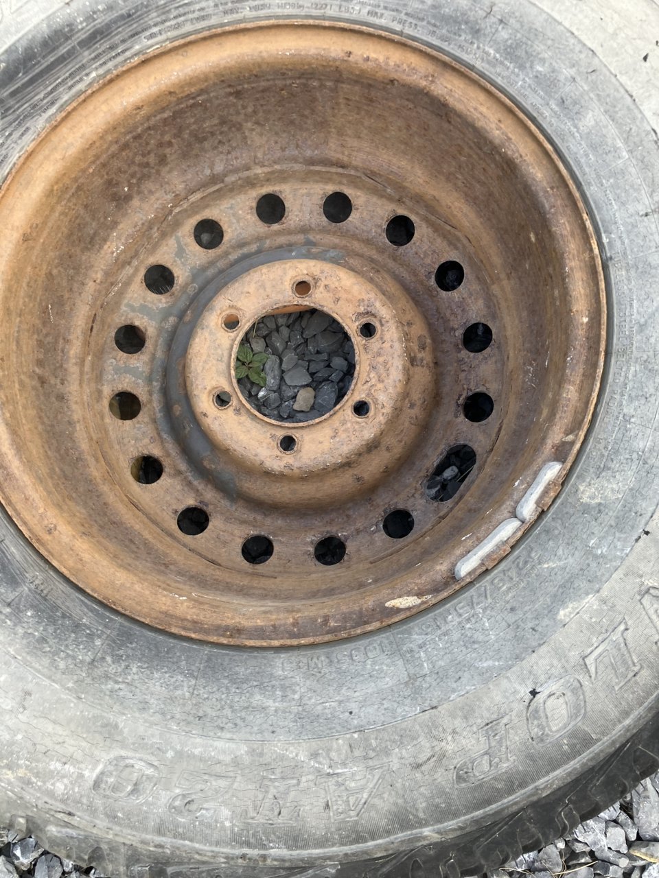

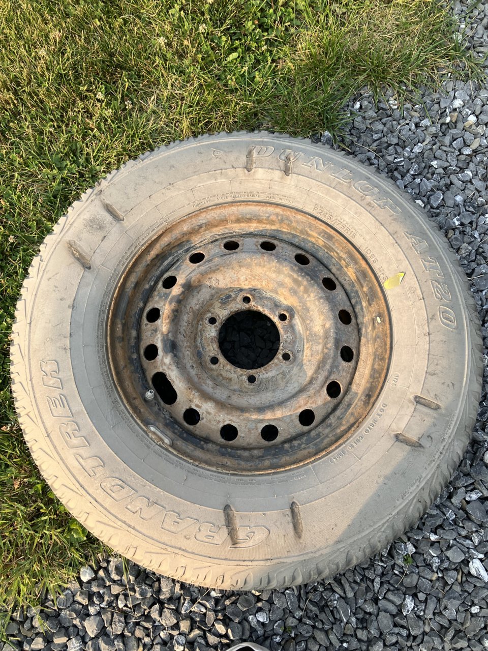

    Current state of my spare tire. My “new to me” 2007 Tacoma.

    I looks like someone cranked the spare tire winch really tight and pulled the spare up against the metal spare tire "frame". From the pictures, it looks like the side wall is grooved in 8 spots. If the sidewall is really grooved that badly (and not an optical illusion in the pic), I wouldn't use that tire...sidewalls aren't thick and a blowout of the sidewall while driving would be dangerous.
    Perhaps the tire is just scuffed, but the picture looks like the tire is damaged.

    The date code on that tire is 1006, October 2006. My spare looked like that minus the rust. When I put in a new TPMS sensor the sidewalls started cracking.

    The tire and wheel definitely need replacing.
    I just traded my steelies for alloys so I’ll have to find an appropriate replacement.
