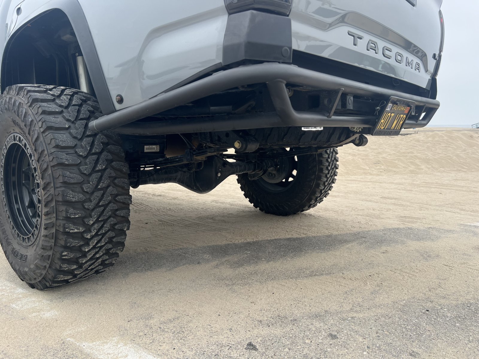

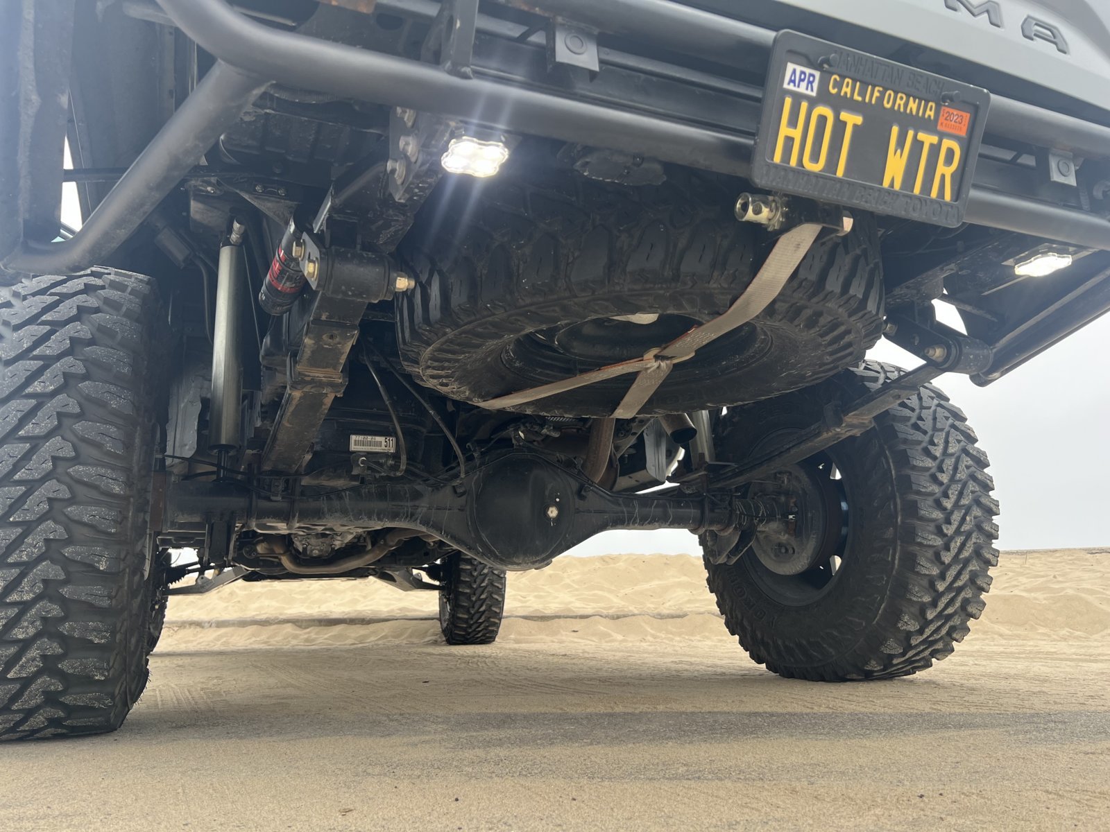

Spare tire location. Is this ok?

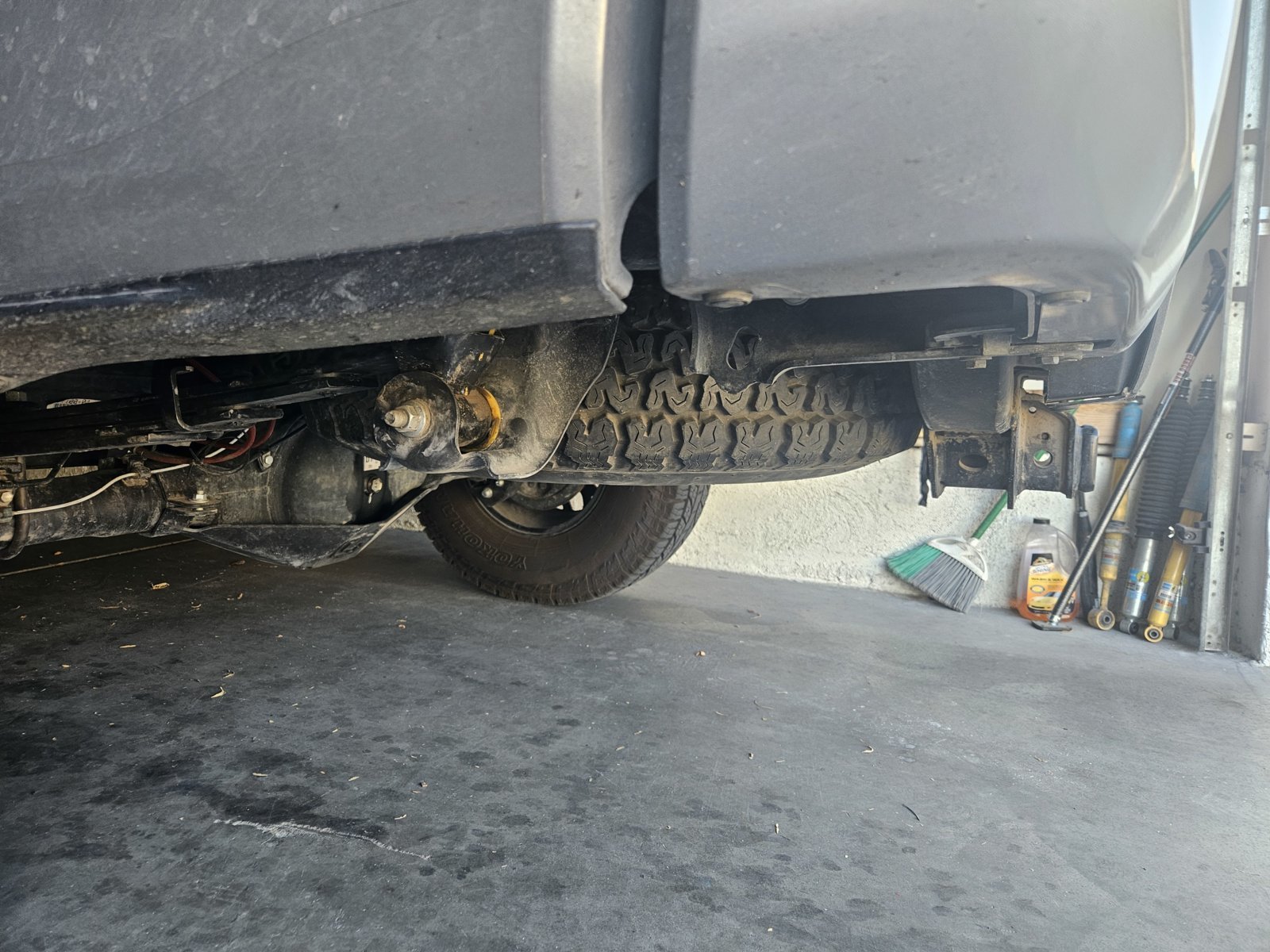

  5. May 27, 2024 at 6:17 PM
    #25
    Mrcooperou812
    Mrcooperou812 Well-Known Member
    Nov 26, 2023
    #438257
    445
    Las Vegas NV
    2016 DCSB OR 4WD
    This is my spare 255/85r16 underneath. Hangs about even with frame sides and higher than the hitch receiver.

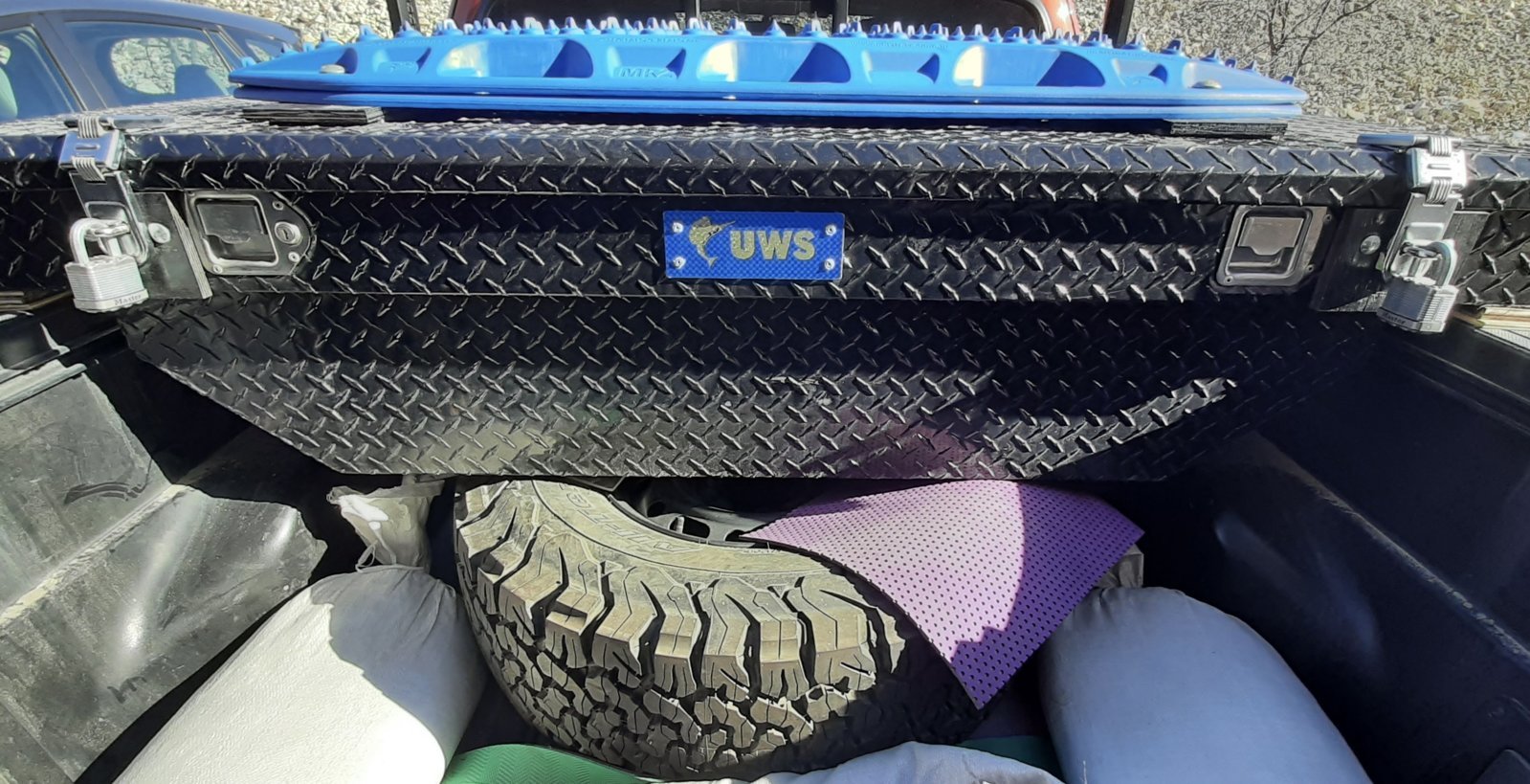

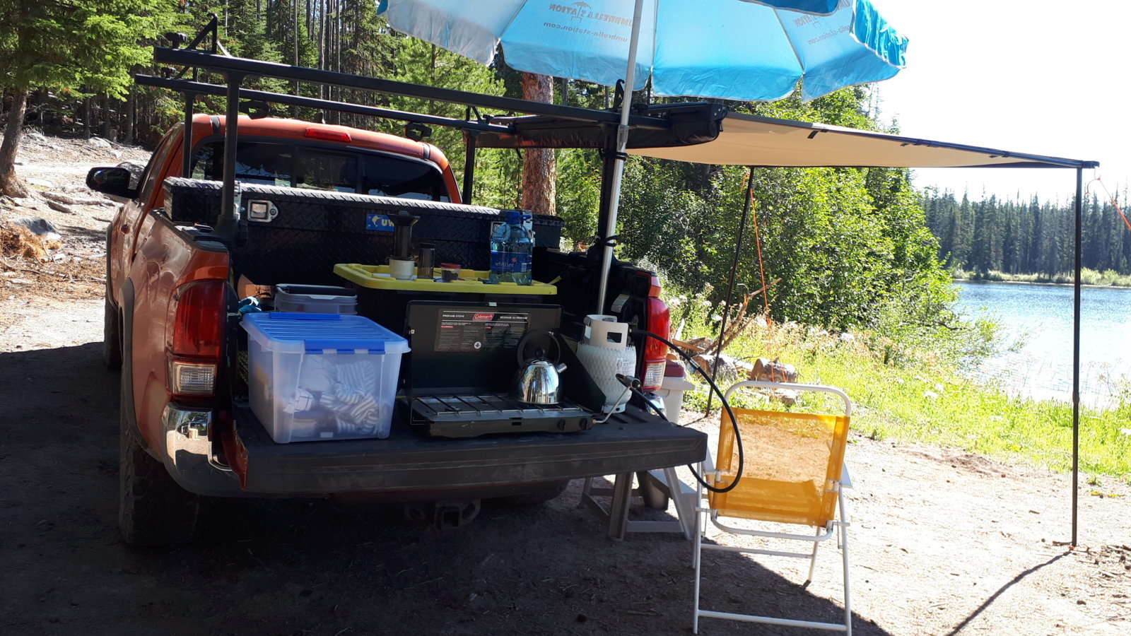

  12. May 29, 2024 at 6:51 AM
    #32
    ppat4
    ppat4 Well-Known Member
    Oct 7, 2019
    #307325
    1,004
    Paul
    Kelowna, BC
    2016 Tacoma TRD Off-Road Access Cab
    Just added toolbox and roof-rack to haul my fishing boat 100's of miles into the backwoods every week. Goodrich K02s, Bilstein 5100 front and back, no lift.
    Does not suit your setup, but I have mine bolted right through the bottom of my toolbox. Some added security and don’t have to crawl under the truck for a flat. Which I have done in very nasty offroad conditions and what a headache.
    Toolbox is mounted over my rear axle to add weight there and I still have an equal amount of room in front of and behind the box for all of my camping/fishing gear for frequent trips. 6ft box on the Taco.
