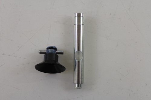

    Sorry to bump an old thread, I attempted to install this lock today on a 2017 but can't get it to stay in. I pushed it in to the existing receiver as far as I could get it to go, tried to remove it by hand and was unsuccessful so thought it was good. After I crank back up the spare and remove the tool, the lock falls right out. This happened twice, the second time I taped it with a rubber mallet a few times. Can someone verify I have the right part, I am unsure how it actually locks in to the "socket" already there. Attached a picture of the receiving part on the truck and the part I have.

    You have the right part. Check post #10 for usage of the key. My post is #18 with the instructions.
    Mine (black lock part) initially did not want to stay on. I needed a socket and a mallet to secure the lock to the stem. Took a few good whacks until it finally seated.

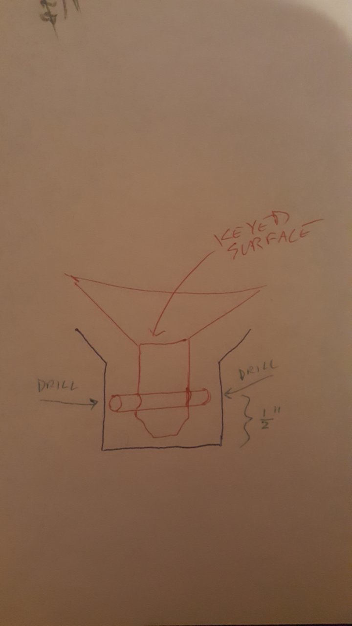

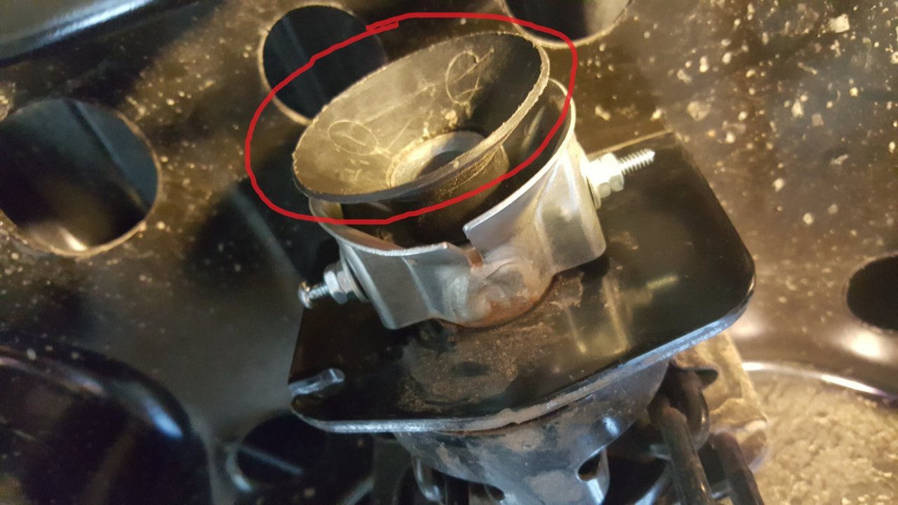

    Someone actually did steal my spare by defeating this system somehow. I found the spare missing, along with the crank insert with the female keyed surface (circled structure in the photo). I found the insert on the ground not far from the truck. I'm not sure how this was done but I figure they must have used some sort of tool to reach the insert and pop it off of the crank. Without the insert in place, the crank can be turned with any tool that can reach it. I came up with a simple solution to prevent such an attack in the future, and to prevent accidental dislogement of the insert (which has also happened to me). Drill a hole on either side of the metal housing and put a machine screw through, securing the insert in place. The insert has a tube going through its core that you can pass the screw through (see diagram). It is just under 4mm in diameter. Use a screw of size #6 or smaller, and length 2.5-3". Make sure you thread-lock it, because if it works loose it could migrate out so that it hits surrounding structures and blocks its own rotation.

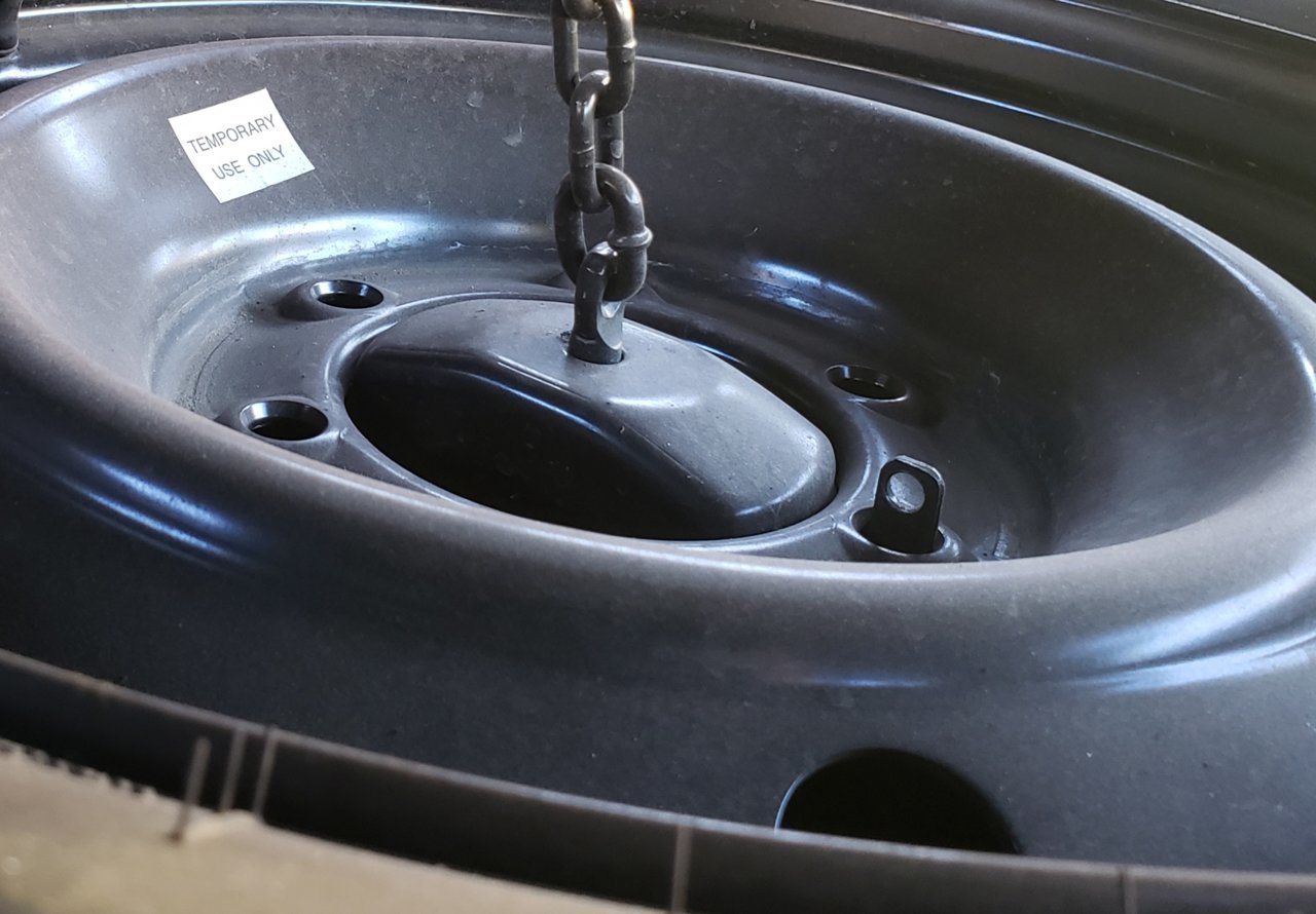

    Additional security. If you are using a steel wheel for a spare you can add a padlock to the retainer bracket on the inside of the spare, the bracket has a padlock flange which protrudes up thru the lug nut hole:

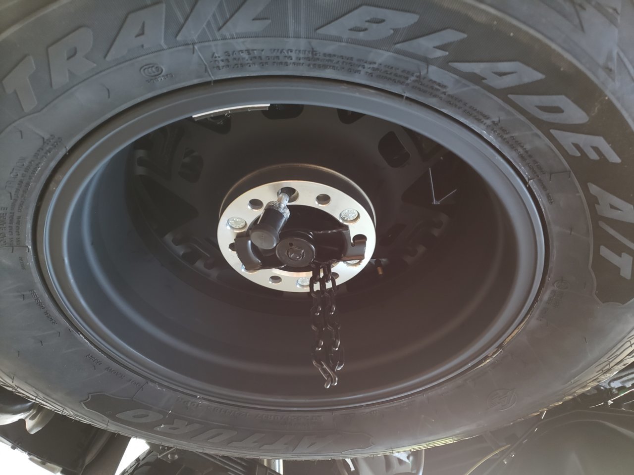

    I replaced my wheel with a TRD Pro wheel which is thicker so used a Trimax spare cable lock and wheel spacer instead:
    https://www.amazon.com/Trimax-Trima...Trimax+cable&qid=1566994720&s=gateway&sr=8-19

    Apologies for the gravedig, but what did you loop the other end of the Trimax lock around? You mention the spacer but it’s not clear to me how that relates. Thanks!
