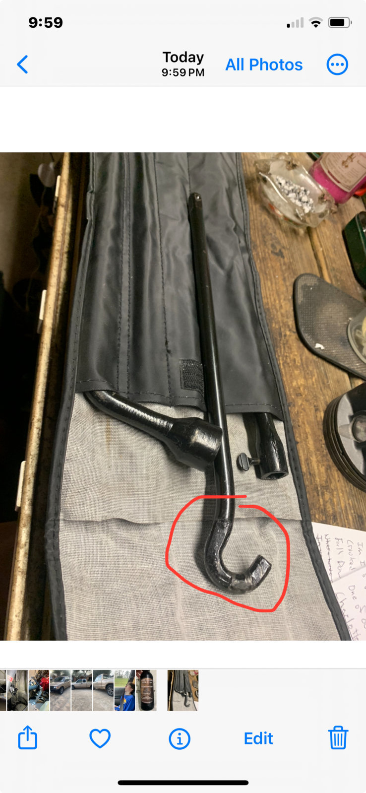

    That ‘key’ is in one end of the rods in the spare tire vinyl pack
    You lost that?
    lemme go outside real fast…..

    That hook turns the spare tire hoist
    (Once all the rods in the pack put together)

    Unfortunately that hook doesn’t work for mine. Wes’s some type of fitting. Like a lug nut lock fitting.

    Thanks but I just bought the truck and that rod is not there.

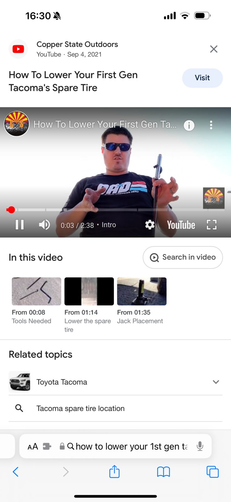

    I am ready to remove the lock as I can’t find a key that fits. Is there a way to remove it with the tire still on? Or a way to lower the tire without the key? Super crazy.

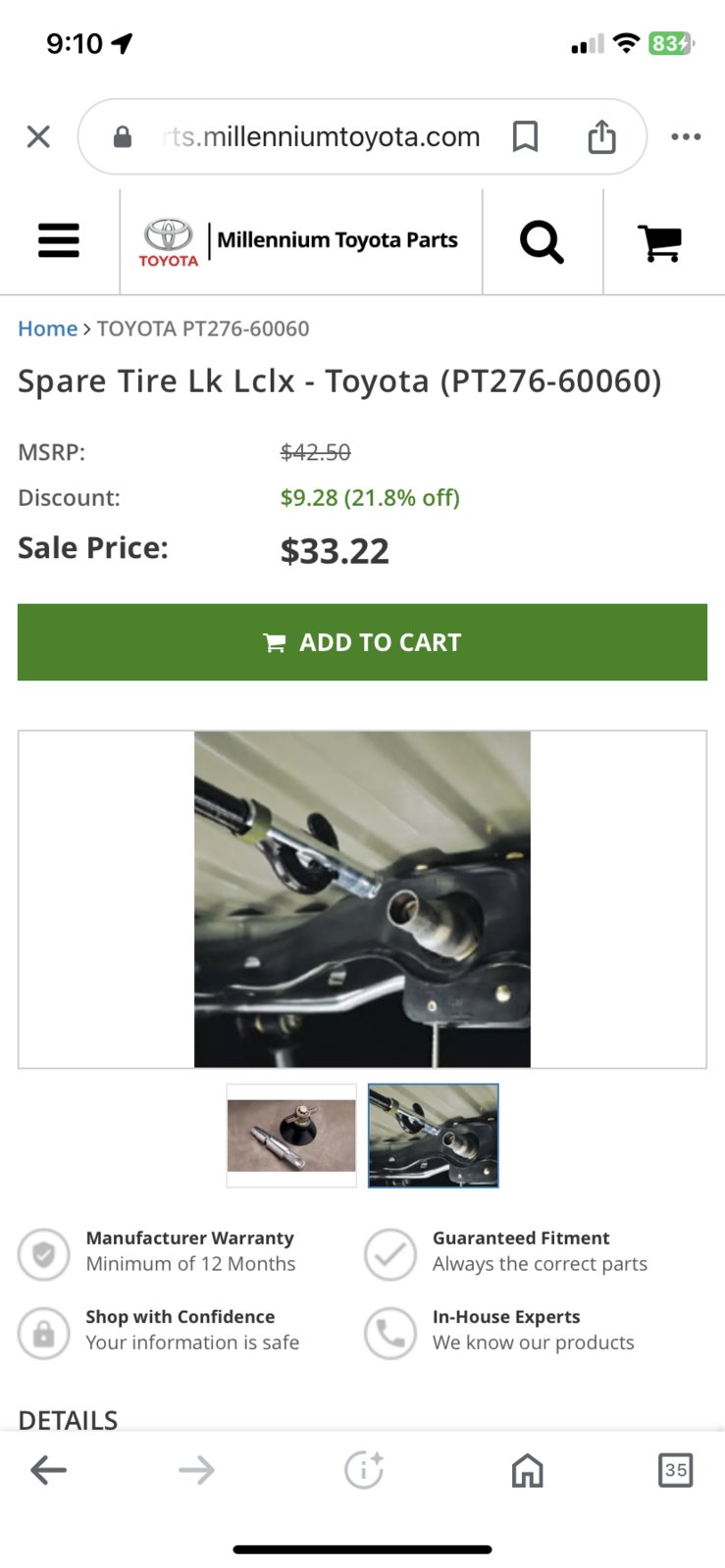

    Tried to pry the lock off. No luck. Finally went to a dealer that had a sample set on hand of about sixteen different patterns in a metal box and found the ‘one’ that matched. $80 to order a new one. It also took a parts guy that knew what he was doing. This was the second dealer I tried…. So call ahead to make sure they have the box.

    I believe the Card that came with mine said 'McGard" or something like that. It had the # for the part to order a replacement
