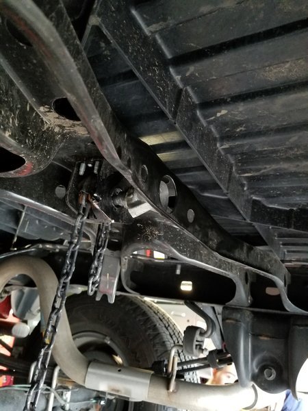

    There is a spring pin that holds the entire assembly to the winch shaft. It didnt take too much to hammer that spring pin out and slide the entire assembly off the shaft.

    Im not blaming anyone but myself. No one said anything about a roll pin. Mine was tac welded. So we cut the tac weld with a wheel cutter, and tried to pry the lock off whit a long pry bar like someone said and we broke the assembly. It would have been easier to takeout the 4 bolts that holds the assembly up, then separate it on the work bench in a vise. Just saying prying it off, does not always work
