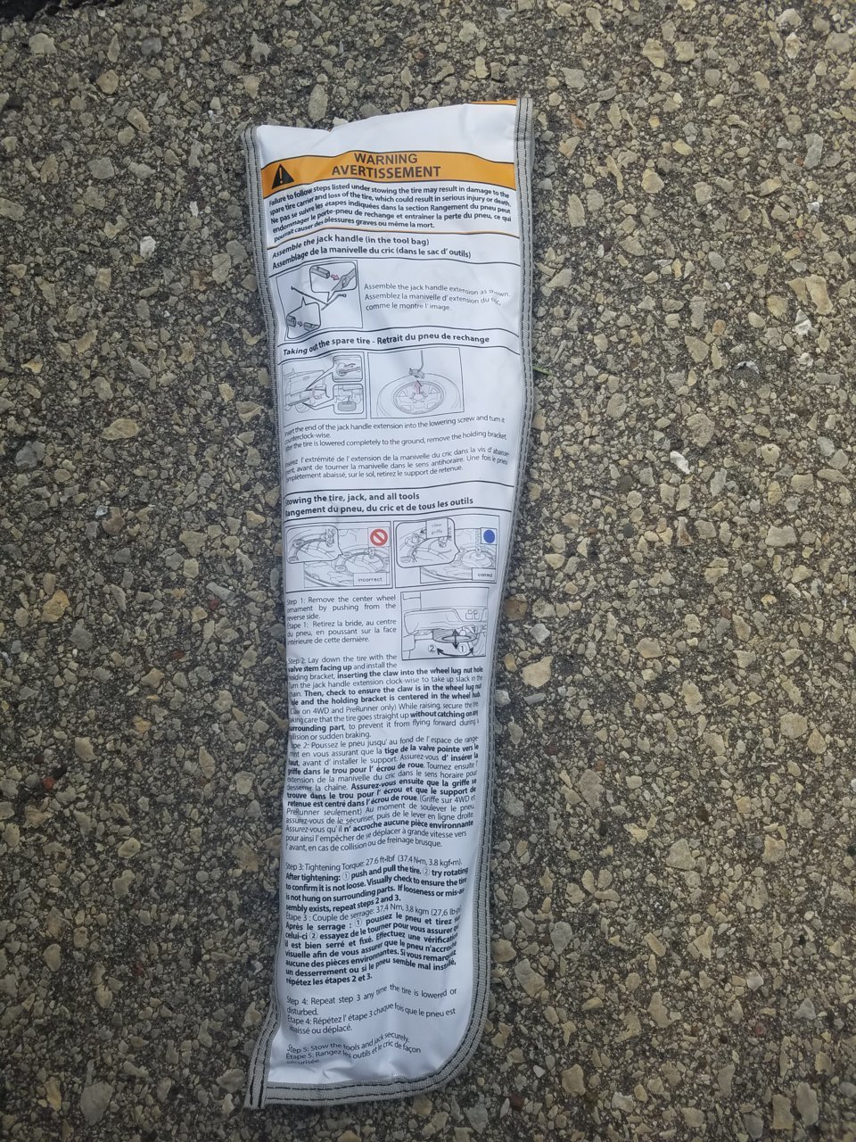

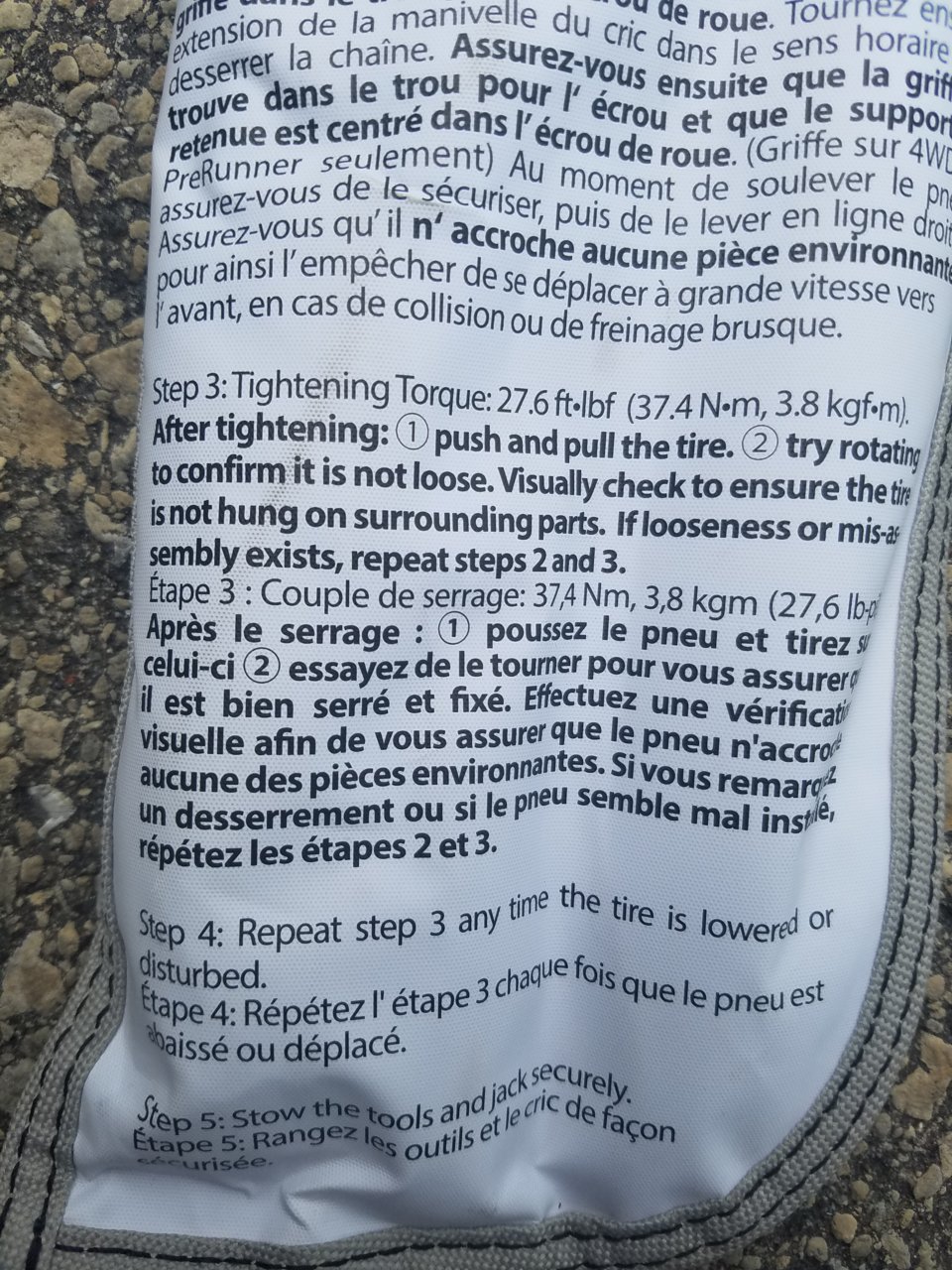

    Yeah, its right on rod/ tire iron pouch in English and French. Ill take a pic tomorrow.

    My take on this is that they list a torque spec so people will have an idea of how tight it needs to be, to help prevent overtightening & to cover their asses. Like in service manuals, they list torque specs for everything cause they have to, it doesn't mean that absolutely every nut & bolt needs to be torqued to exact spec. So if/when an owner happens to break it by overtightening, they have something to fall back on, "torque spec is provided & the owner did not follow".

    exactly. Mainly pondered if there was an actual method to do that with a standard torque wrench.

    I would agree with that on the most part except they have such an exact number at 27.6.

    That .6 is what I found funny. Click type & bar type torque wrenches don't have a resolution of tenths of a ft/lb. IIRC my digital Snap On can but I highly doubt it's even accurate down to a tenth.

    I saw that torque and thought it was weird even though I'm a torque nazi. But here's the thing, there is a spring on the end of the fitting that goes into the spare wheel. If you crank it up so that spring is compressed a bit, it will work like a lock washer and be worry free.
