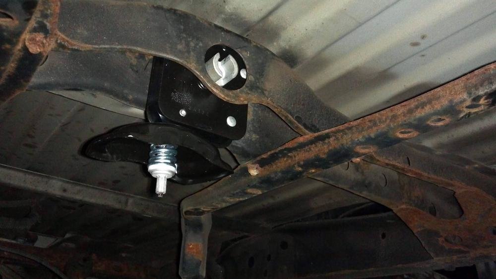

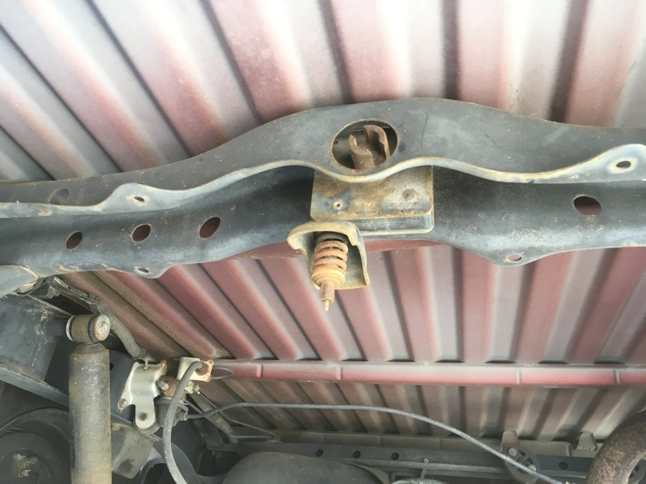

    The stock “slot” version looks like these:
    (my truck)
    (Not my truck)
    (Images taken in regards to the spare tire strakes, which I located, sanded repainted, & installed)
