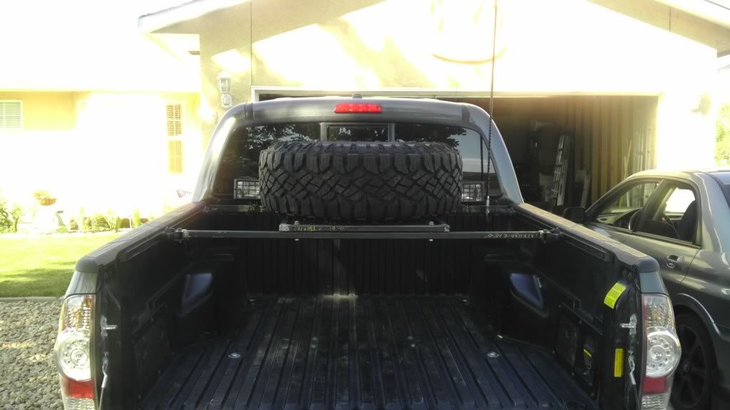

    Here is a pic of mine. I needed to be able to slide it to the side for transpoing by moto. Ain't real pretty but works well.

    That's pretty nice, i really like now small and simple it is. Great job man

    Thanks. It's worked out really well. I figured at some point I'd need to bolt it to the bed but there's been no need. Even when wheeling through rough river beds it hasn't moved. I don't think I'd jump without bolting it down but my truck isn't build for jumping anyway. Checkout Metalmiller's new mount. It looks super simple and apparently it holds up well.

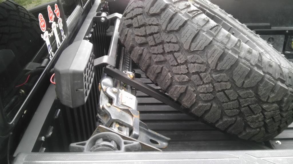

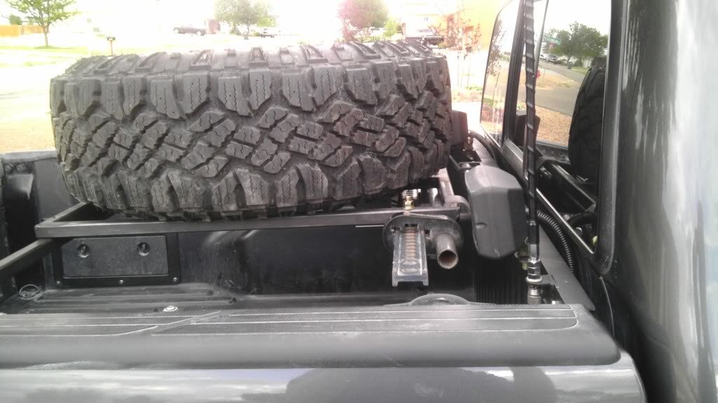

    I got my idea from Rubie. Used some hinges from Northern Tool to lift it out of the way when I need the whole bed.
    I used 1" flat bar and cut it so it would slide in the bed rails. Then welded the bolt head to it so I could tighten the hinges down. It works great so far.
    The next 2 pics show the tire lifted up so the bed space below can be used. I used a piece of left over square tube to go across the bed to support the tire.

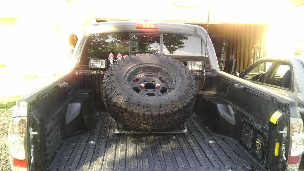

    First one was when i still had a stock spare.
