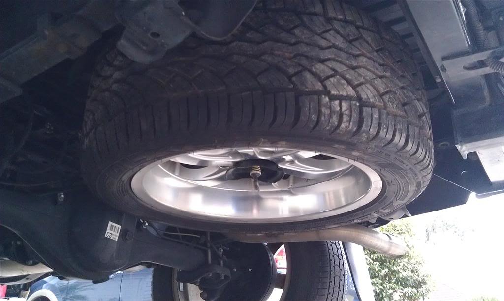

    I just switched to 255s and wanted to see how my spare might fit in the stock location, so I made a video for the rest of you to see the results as well. If anyone has video for other generations or alternatives, please post up and I will add it to this first post

    Be interesting to see if somebody figures out a way to wedge that size up there

    If you notice, he said he had to "kick the tire into place", which most likely means the tire is being pinched.

    Ive got my full size spare in that space: Cooper S/T 255/85/16. My exhaust is chopped so the exhaust hanger isnt in the way. I did use a BFH to beat back the metal pieces that helps to keep the stock spare tire in place. It fits, no diff rubbing.
