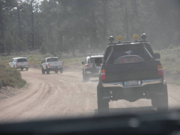

    here is my n-fab carrier with my old wheels, it holds the new 17's with no problem. it slides on the factory rails. no problems with it yet.

    I like the idea it sits right in your bedrails like that. No drilling or cutting into the bed that way. The only issue I would have is my tonneau cover will no longer fit if I stick a 33 up on that thing. Guess I may be selling that T cover here soon then.
    Thanks for the picture

    I think that will work, Dave. I was looking at doing that to mine. It's just two little tabs that stick down to align the tire. I'm pretty sure when I measured mine that a 33 would fit.
