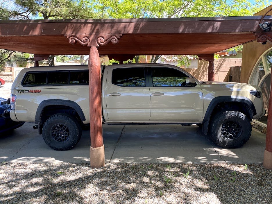

    I am running 285/75R16 on my new 2020 OR. I currently do not own a jack that will work with my applcation, so I cannot test this.
    I need to know if this tire size will fit in the spare tire area without having issues from the exhaust.
    Also what is the most cost effective/ reliable way to jack the truck up. I have a 3" bilstein 5100 lift so the OEM jack is inefective.
