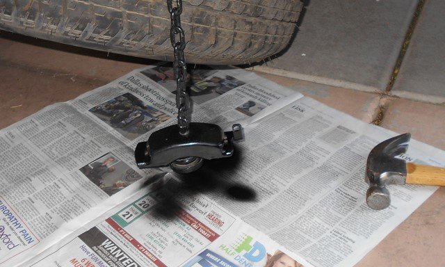

    After a lot of driving offroad - and many different vehicles - I can say I've never had a damaged stem on a spare. Must be nearly impossible or I would have busted one. They have to be capped though or mud will fill the stem hole.
    On the Tacoma - mine has the 18 x 7.5 factory aluminum rims with the fakey plastic chrome covers on the road wheels and a bare rim for the spare. When I flipped it to stem down, the hanger wouldn't engage the wheel face due to some unnecessary appendages. Removed spare (again) and with a 4-1/2 inch angle grinder and a hammer re-adjusted the fit - painted black to suit.
    Re-shaped Spare Hanger.jpg If you want to keep it - be sure and lock it to the Truck with a loop and lock.

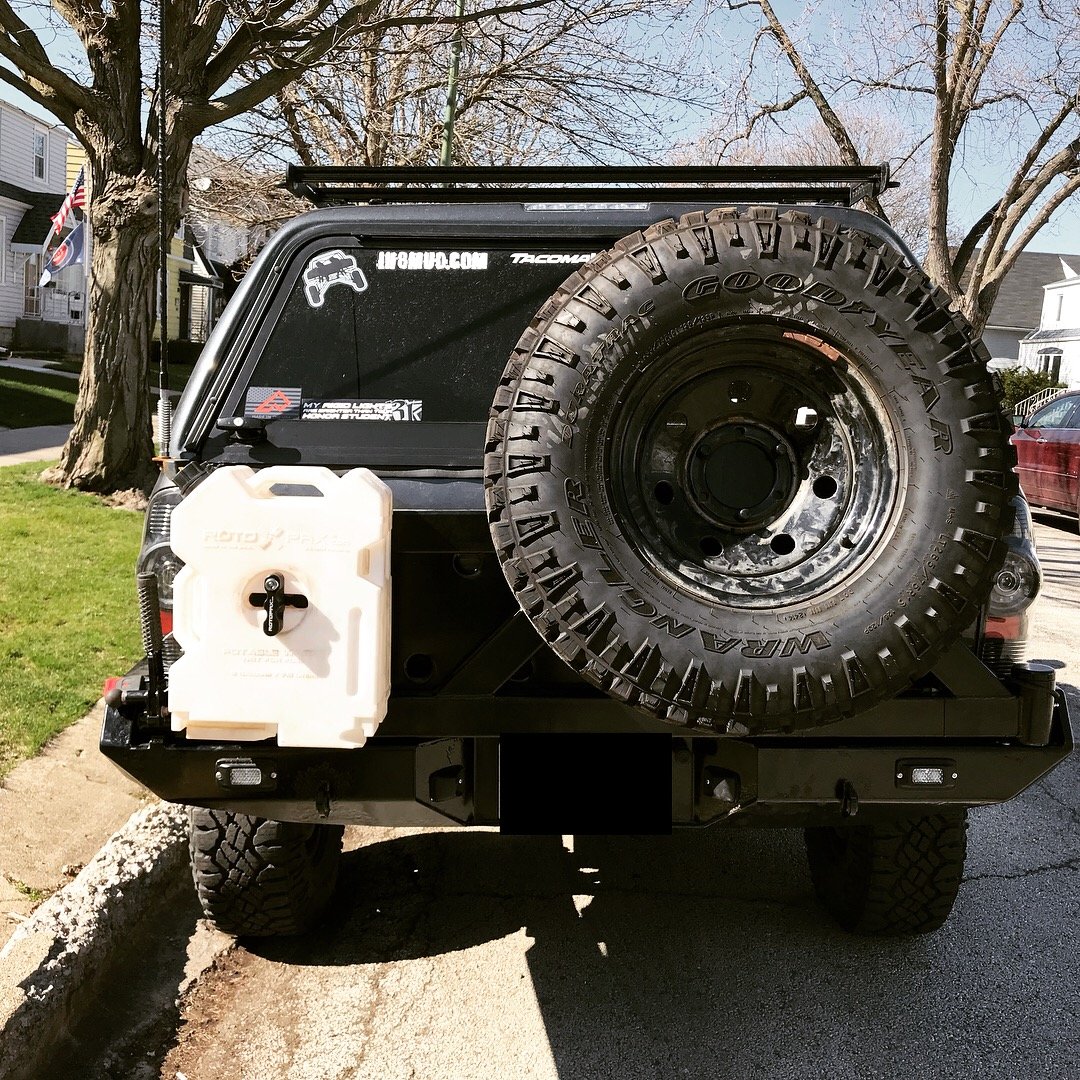

    I got rid of my stock spare tire carrier. I don't think I will have to replace my tool set for a long time (forever).
    Oh, here's how I and many others like me are battling this epidemic:
