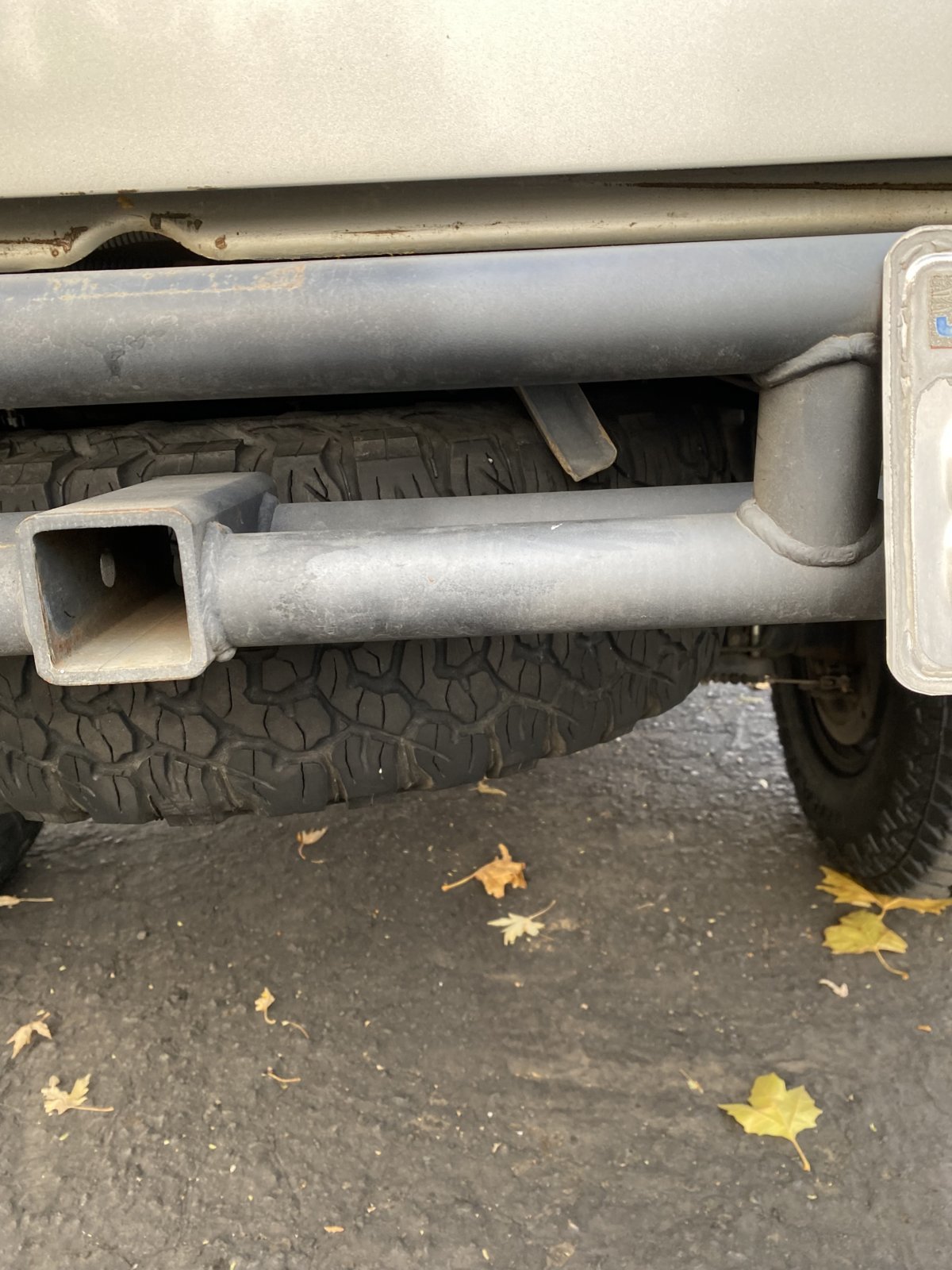

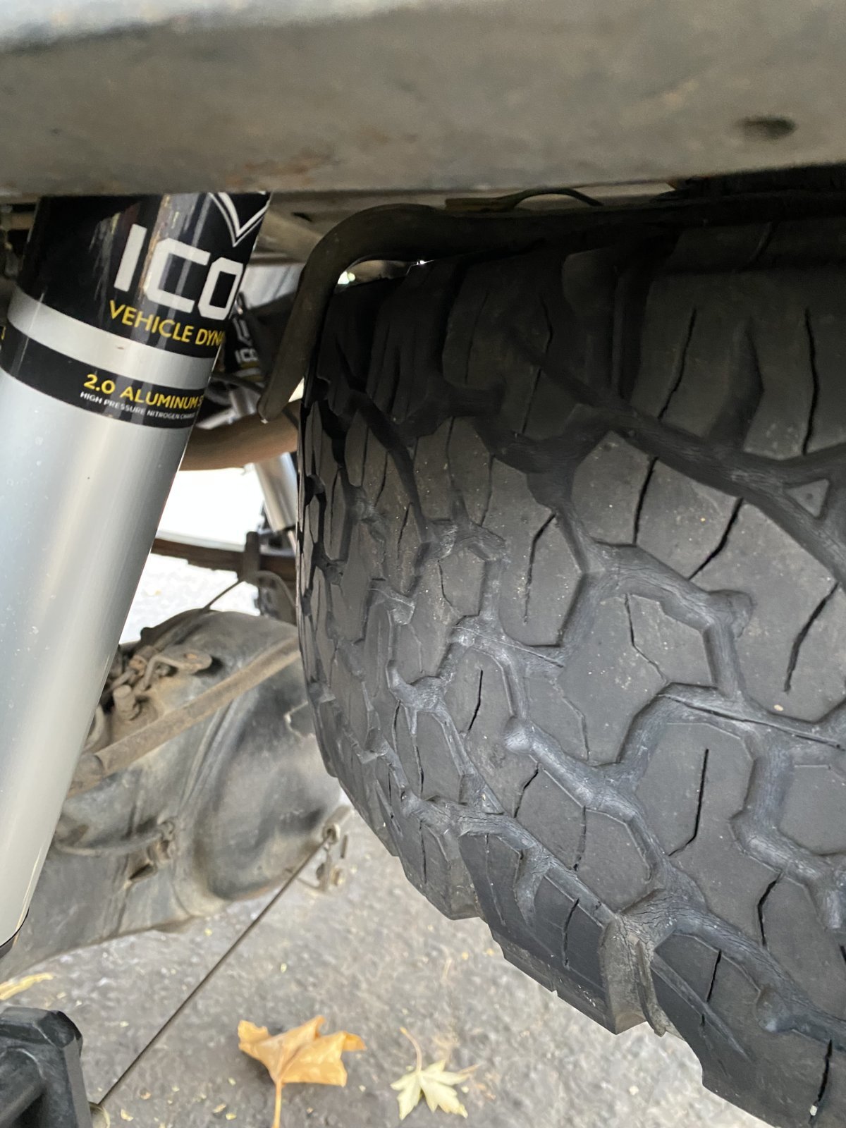

    When I replaced my old 265/75/16’s. I put the best tire out of that set as the spare. It fits just fine in the stock location. Sorry.
    Not the best pics.

    Great! Thanks for the pics, that's super helpful.
