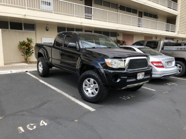

    I finally put 285’s on and want to know if I need to change my spare tire, and if so what will fit that would work solely as a spare. Someone told me 33’s but I heard that won’t fit underneath my 2nd gen. Thanks in advance.

    Thanks, this is what I was thinking. I hardly go off-roading but I plan to... but I’ve always planned to (since 08) and never really have done anything long or difficult. It’s not my daily but I like driving it more than my car so I drive it as often as I can.
    Pretty sure I’ll just go with an inexpensive used 265/75/16 as my spare. I only have the stock jack so I don’t plan on doing any hard off-roading.
