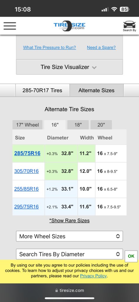

    Here’s a good site to check-
    FireFlyfishing[OP] likes this.

    Bingo! Thx @hyrule_trd!
    Looks like the 285/75r16 is the ticket for that factory rim I have!

    If that’s the case, a 255/85/16 might be a better fit if the spare wheel is smaller width. I also know it fits well in the spare slot once you hammer the ears out some.

    I’ll look at that one too. You bring up a good point.
