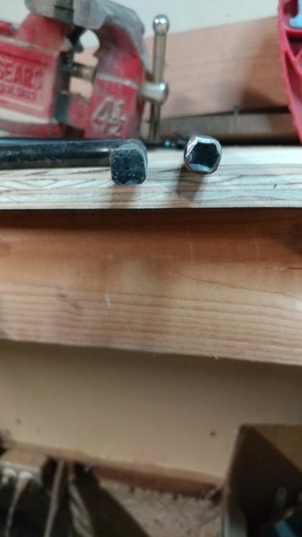

    Thanks everyone for your advice. I ended up going to the local "stealership" and buying the hook segment for the newer tacomas ('05-'15) I learned that the difference is the older version has a square fitting whereas the newer version has a hexagon fitting. Seems like a bit of a dick obsolescence move on Toyota's part, but that didn't thwart me. To make it work I simply grinded my old square fitting into the hexagon shape of the new segment. I also drilled another pit for the screw to tighten into.

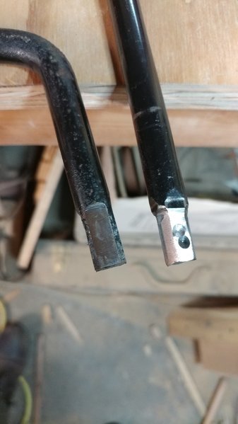

    Then I tried to attach all the segments and realized that not only did they change the square shape to hex, but they reversed the ends of the segment that have the fittings. IE: the ends that had the female receptor now have the male end on the newer version. No problem, just had to grind the end of the "handle" segment. Seen on the left here.
    I tested it out and it works perfectly. In total I spent $40 for the Bottle jack and spare tire tools (and spare center brake lens and bag)... not bad considering they go for about $100 on ebay.
