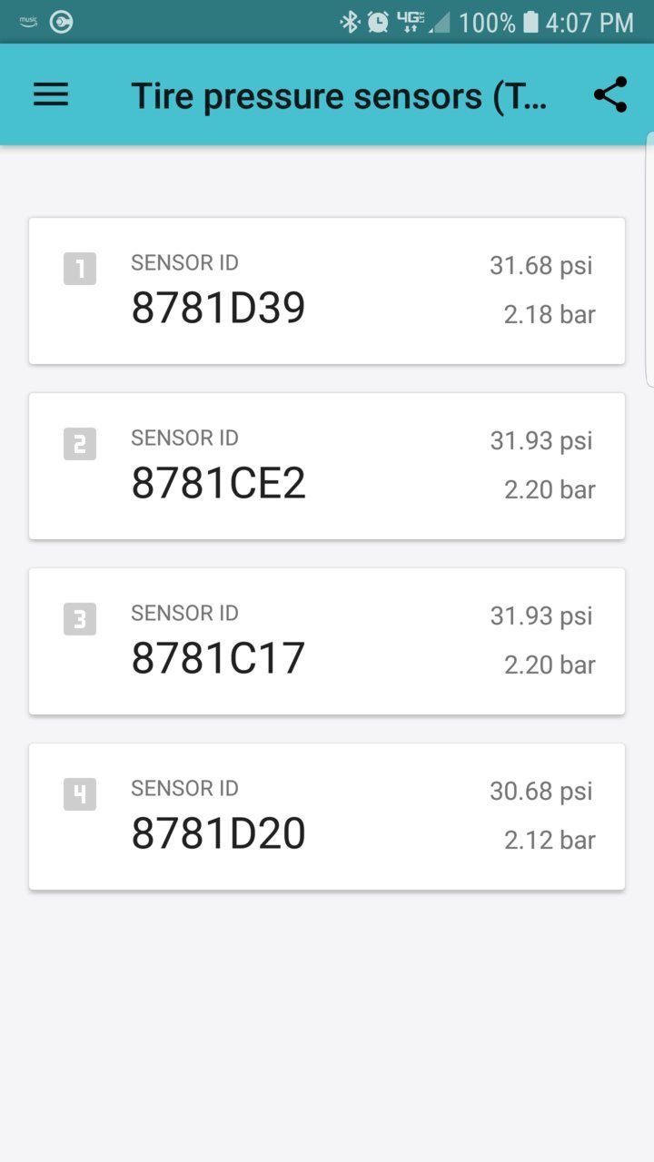

    You just need to get the one going to the spare location replaced with the one on the spare.
    Here's a screen dump:
    Yep! Cool tool, except for the whole subscription thing. I'd certainly pay a price to have a full license. $40/yr is a bit nutty.
