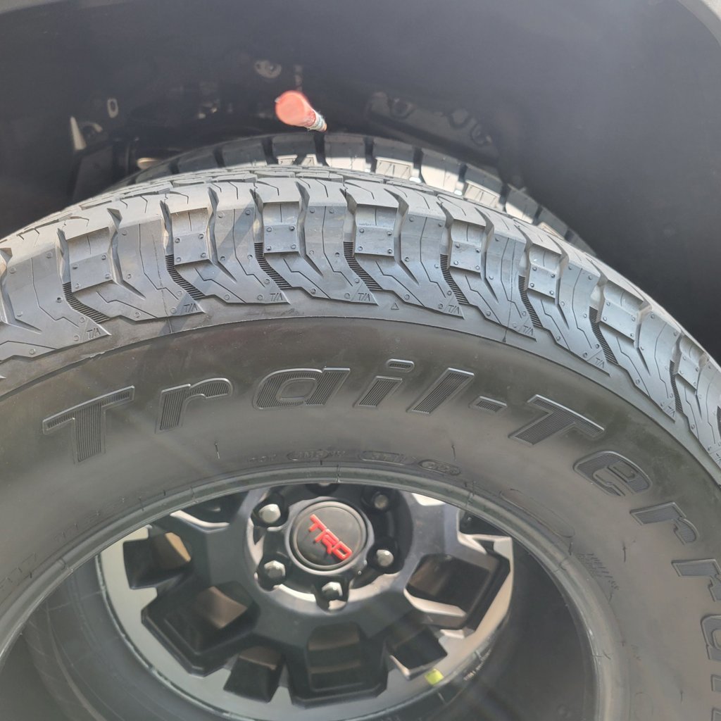

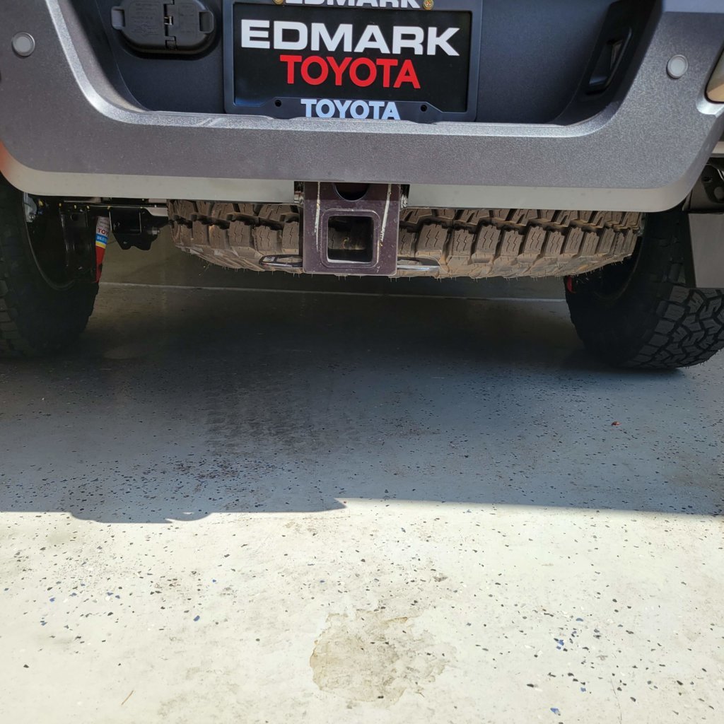

    Here's a 265/70-17 on my 4th gen SR5. There's enough room, but it is a bit low. (Mine had the donut "non-full size" too. I complained aggressively to the dealer & he switched it out to the same wheel & tire as the 4 on the ground.)

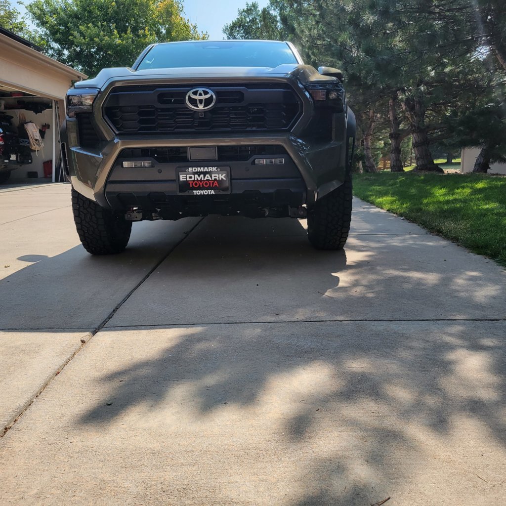

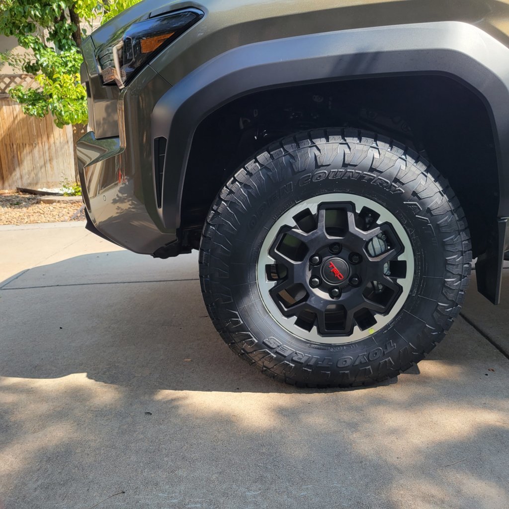

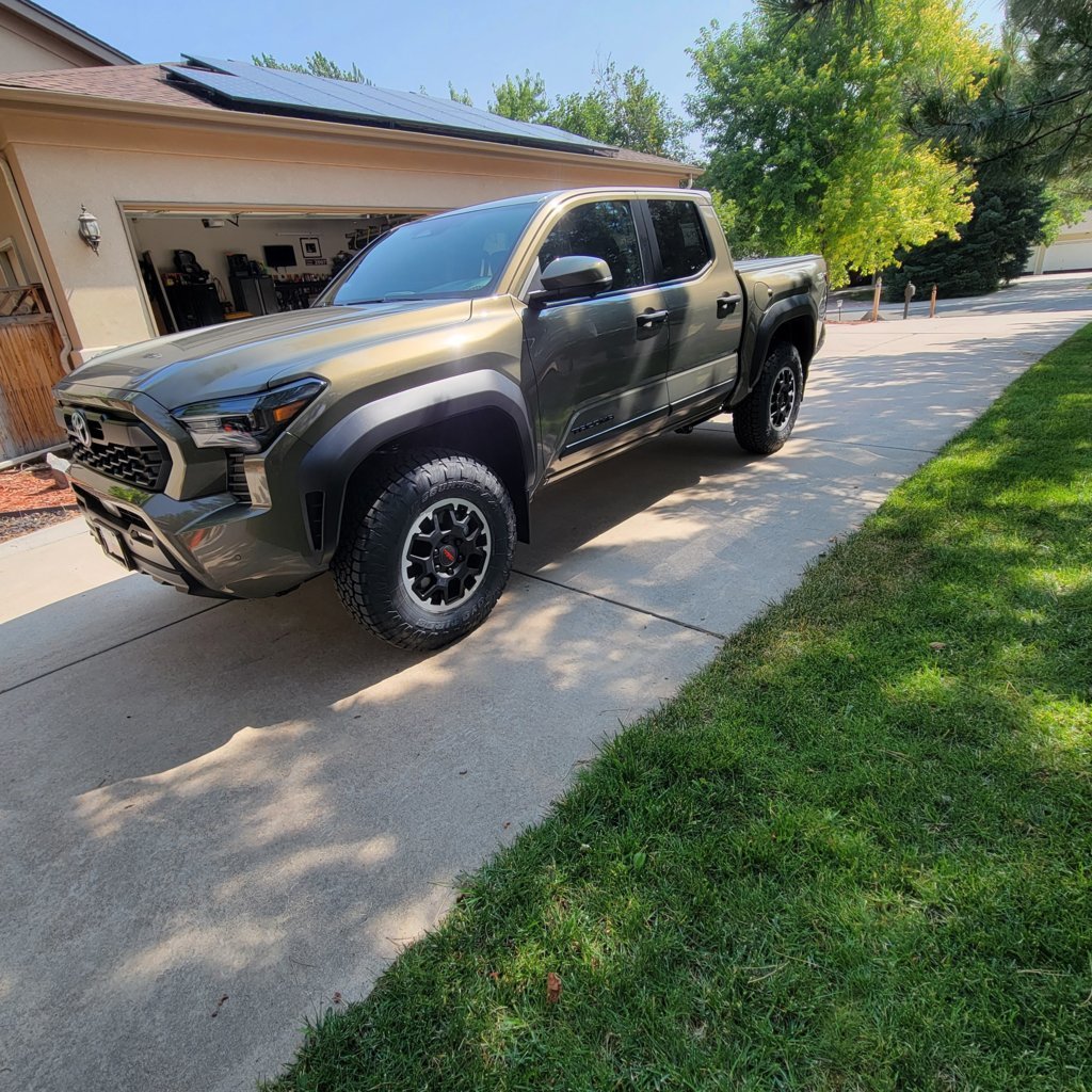

    I am running the Toyo AT3 255 80 r17. I bought 5 and a faactory rim off ebay
    that is a 33.1" tire which is bigger than the 31" tire it came with. The narrower tire fits better in the spare tire location
    This video was a big factor in my going narrower
    https://www.youtube.com/watch?v=6wAJAOxh8LE
    Here is what it looks like as a spare and a comparison to the stock tires it came with
    20240725_102616.jpg 20240725_102159.jpg 20240806_103233.jpg 20240725_102143.jpg 20240725_102238.jpg
