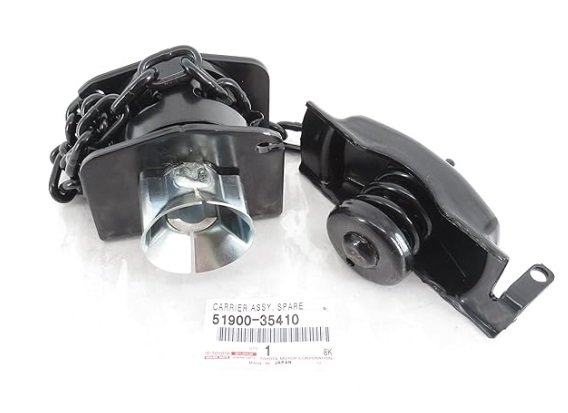

    The spare tire hook (rod) will fit into the slot on the pic. It's not an exact fit rather the curved rod section grabs the ears in the pic. This is on 1st Gen, I would think your 2bd gen is very close to this.
    Hard to explain... Peter in SA

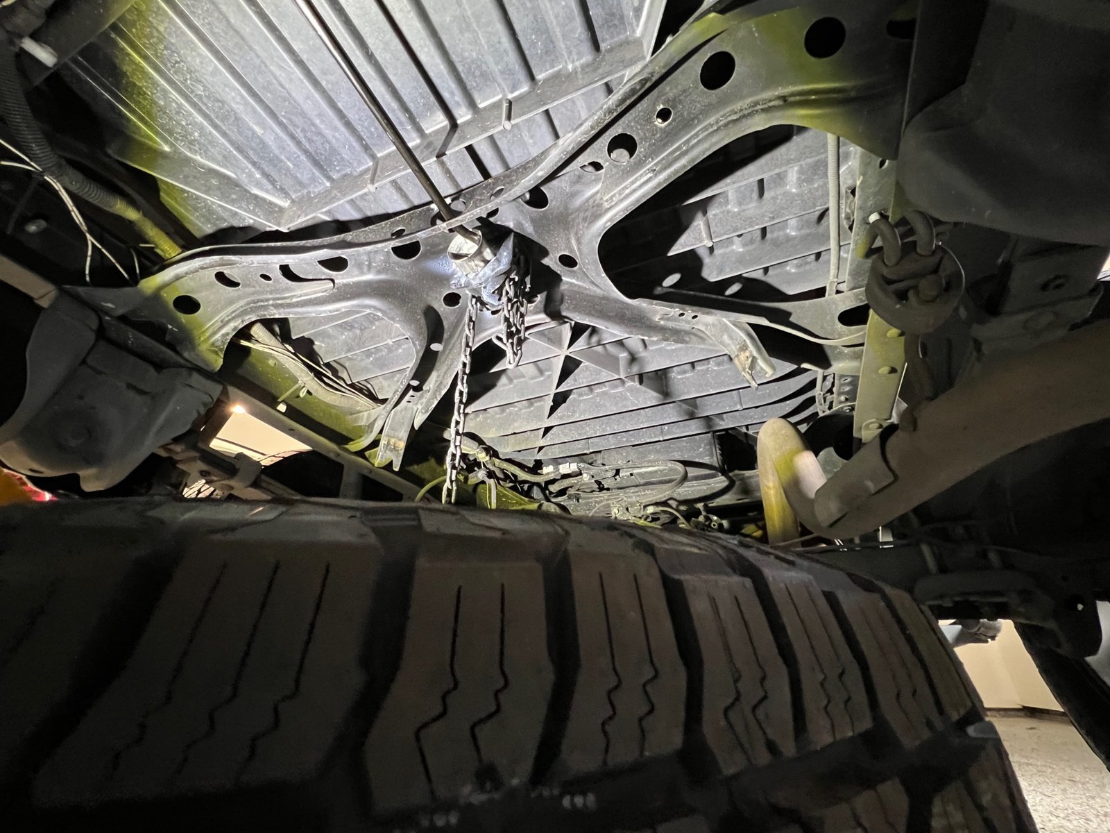

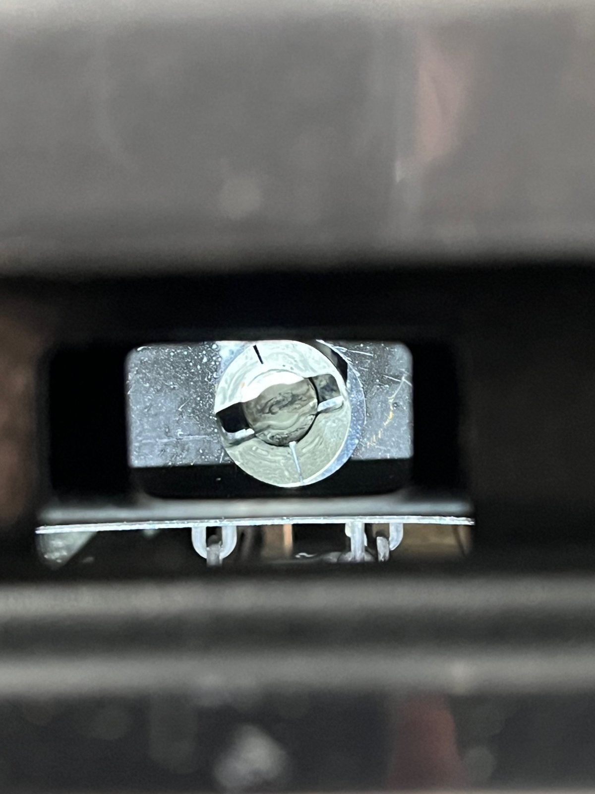

    Concave disk? It sounds like mine, which looks like this through the hole in the bumper:

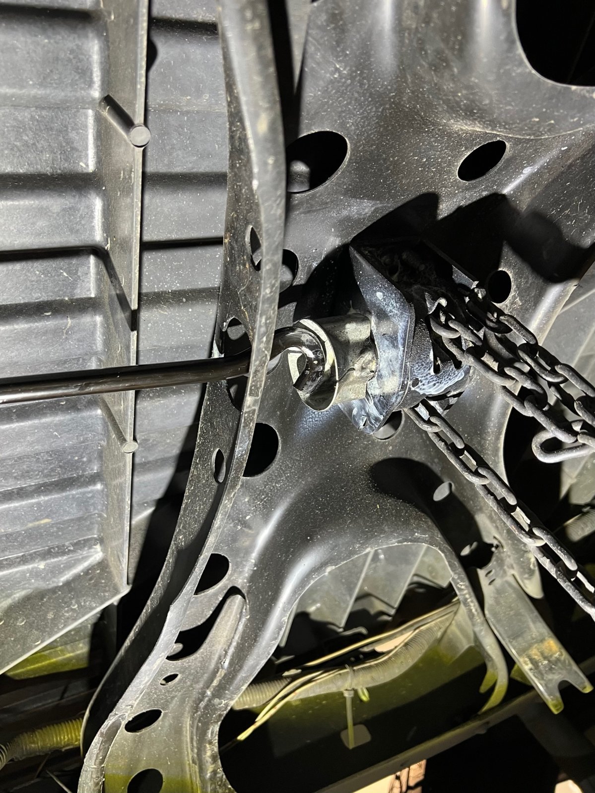

    And from below with the hook in place, tire lowered:
    I pulled the hook out just a little for this picture, disregard the white lithium grease resideue:
