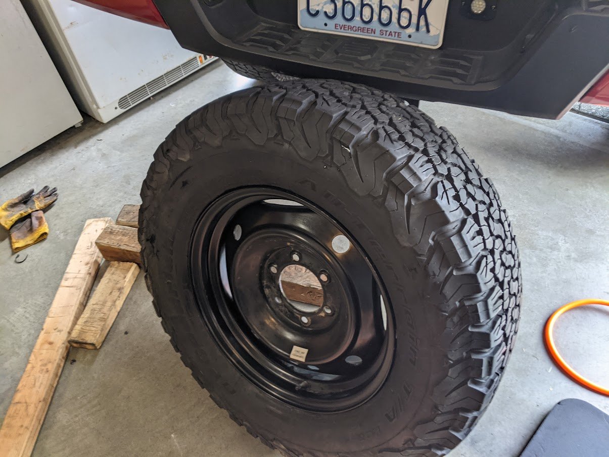

    Is it cool to run a 34 tire on the spare wheel. Or just buy a matching spare? It’s not looking like it is okay imo. Just want to make sure

    What's the recommended rim width on the tire you want to purchase? As long as that fits the stock spare (7" wide) you're fine. If you're beyond that, you'll need to change your spare wheel. For example, BFG specs a 7.5"-9" wheel for a 285/75-16. I'm sure that there are members on here running a 285 spare on a stock steel wheel without drama, but you're outside the range. If you wanted to, you could go with a 285/70-17 on an FJ Cruisier steel wheel (17 x 7.5) without drama.

    Gotta take the width of the tire and the width and the offset of the spare into consideration. Too wide of a tire might not be right for the width of the rim. Too much positive offset of the rim combined with the width of the tire then it might not clear the UCA.

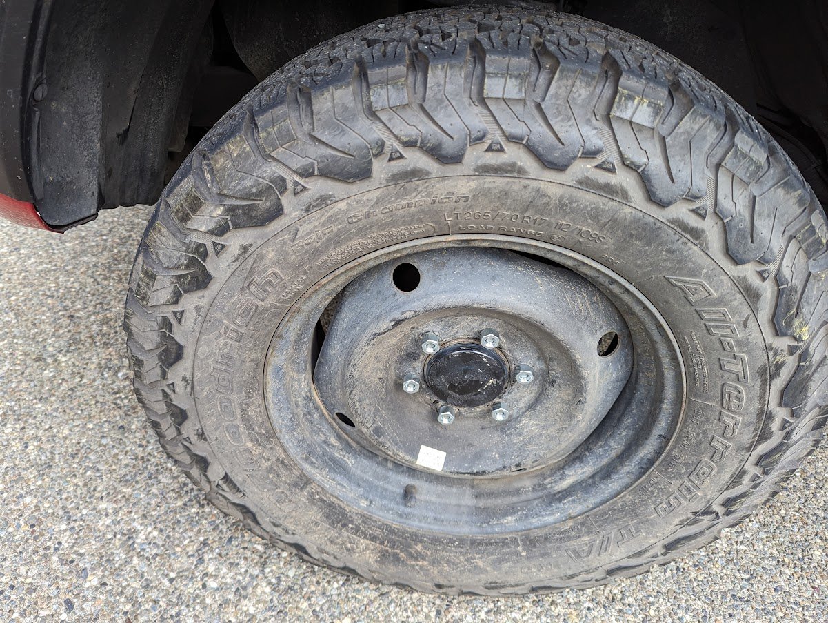

    I had to run my spare for a couple days. Spooned a lightly used KO2 on to the steelie. That was not fun with my lightweight motorcycle tire changer. It was interesting as it was somehow balance perfectly. Minor miracle there. But, the difference in offset had it pulling away from that side under braking. Nothing horrible though.

    Thank you this is literally the info i was looking for. Ill be good.
