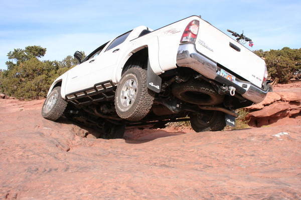

    On my 6 lug I have a 275/75/16 BFG AT (31.65 X 10.43) under mine. Any larger and you have to do some cutting.
    I'm not sure how much room you have on a 5 lug.

    i would think that if a 275/75/16 fit under a six lug then a 31x10.5 would fit under ours, i dont think that would be different but i could be wrong

    i would agree with this. although there are many differences between a 5lug and a 6lug the biggest are the suspension and gearing... so assuming that then it should fit.

    Agreed. There's a thread around here somewhere that shows how to fit a larger spare under the truck. You just cut the bars off that keep a larger tire from fitting.

    Toyota rates the stock 5 lug as being capable of running a 31" tire w/o modifications. I would think the 31" tire would fit.

    You can fit a 31 inch tire under the bed, but it may get close to your exhaust pipe.
