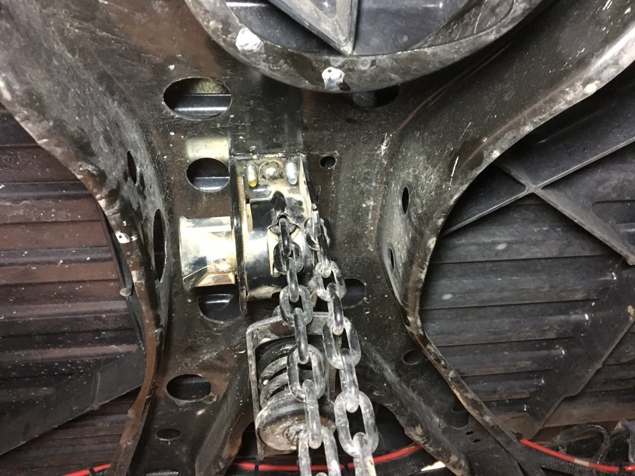

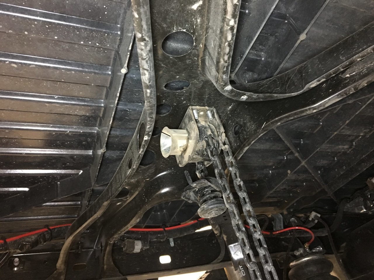

    Some fellas beat those tabs flat with a club hammer. Just gotta make sure the tire is not sitting against the exhaust.
    I my opinion, the first thing to do, prior to bending the tabs, is to relocate the tire hoist and see if that’s enough. It’s super easy. You basically drill two holes and you are done. I’ll see if I can find a link to share.

    You just shift it one set of holes and drill two new ones. There are only 4 holes to begin with.
    maybe you still gotta bend the teeth, but at least the tire hoists up straight without having to pull on it. I run a 32” spare and did this mod. Was no problem.

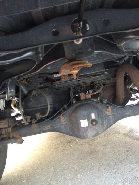

    already showered and got ready for my day. However here’s a google pic it’s the metal piece hanging down on the left near the brake lines. 24DD0127-37FA-44BF-82B1-6CBB5E727D7D.jpg

    Ahh, yeah just whack em with a rubber mallet and be done with it.
    Surprised your 285s aren't fitting up there proper. My 255s are a true 33", where your 285 is closer to 32.8". My exhaust was the only thing in my way, so it whacked.
