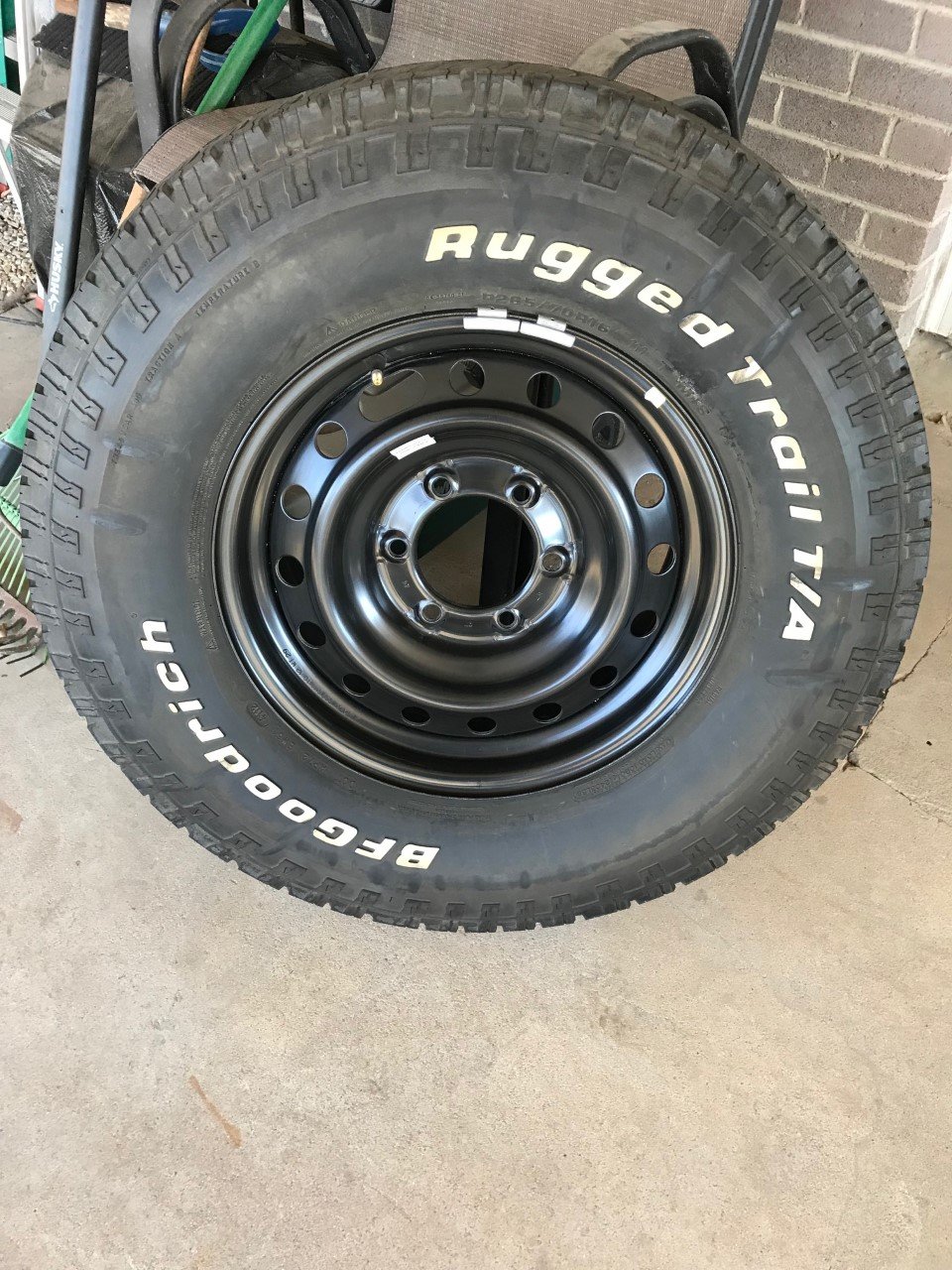

    this was found on FB marketplace for $40, was never on the ground..... also tons of used tires on ebay shipped to you for 100 or less with the tread depth listed and you might find the specific model to match, since you have a wheel, save the hassle of searching locallythumbnail_IMG_8058.jpg
