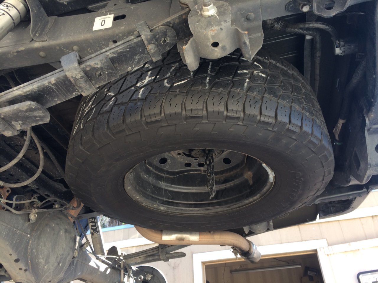

    I was able to fit a 285s or 33s under the bed of my truck where the stock spare went. And I have a tow package, so the tow bar is right there too. You need to smash and bend two of the metal pieces under the truck in the spare tire rim. You need a brass hammer and you need to hit them really hard twice to bend it back about half way for both of them. A friend was kind enough to help me out. He knew what he was doing.

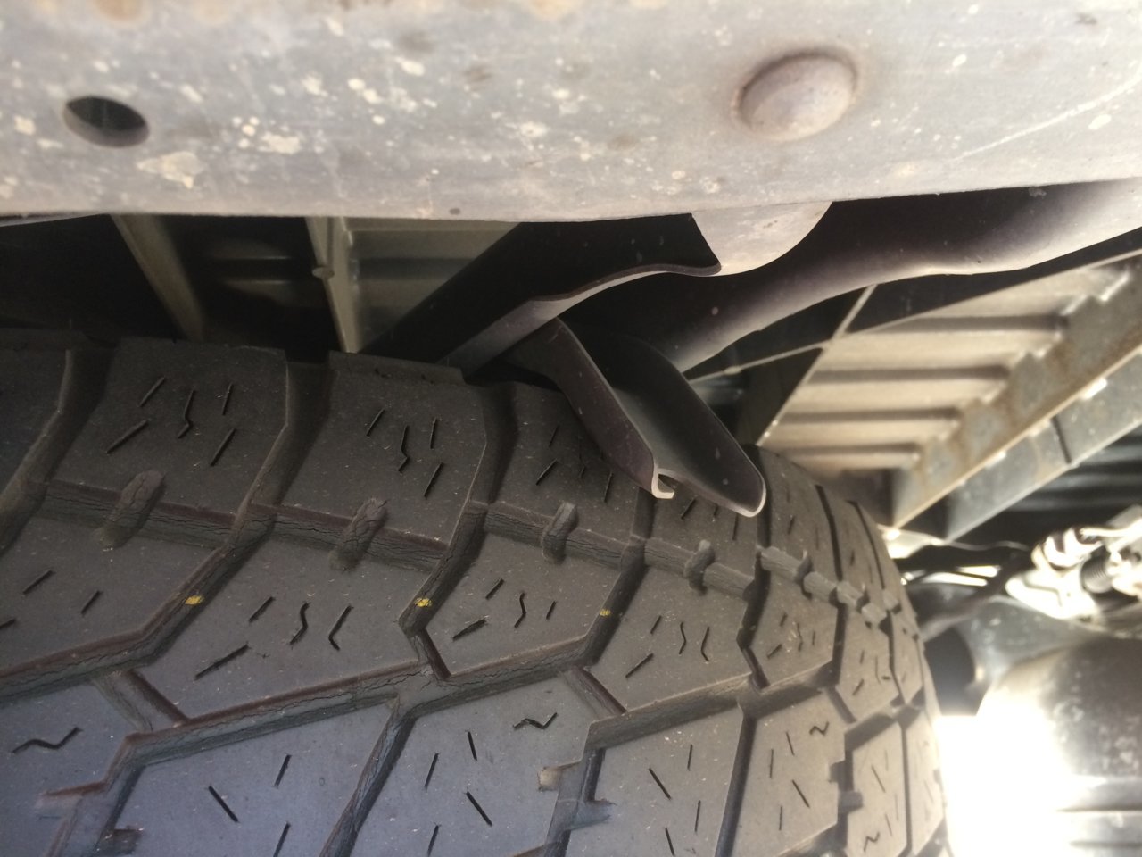

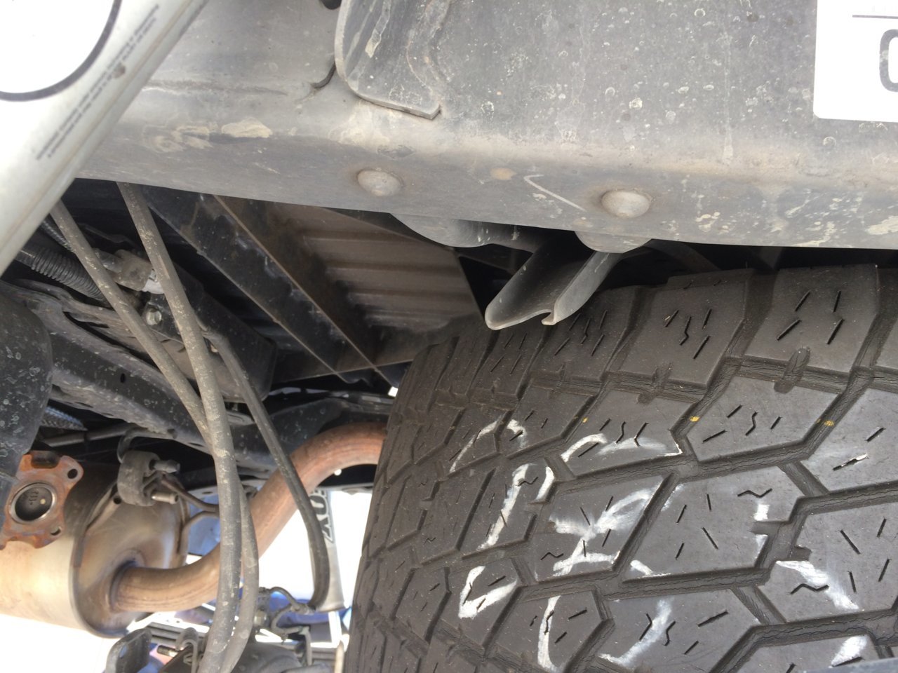

    I took some pictures for those who want to fit their spare 285's/33's under the bed while i had opportunity when my truck was up in the air.
    What you got to do is take a heavy brass hammer (or a Big 3lb hammer) and smash and bend these metal pieces backwards like this
    Once done, it should fit like this 285 spare

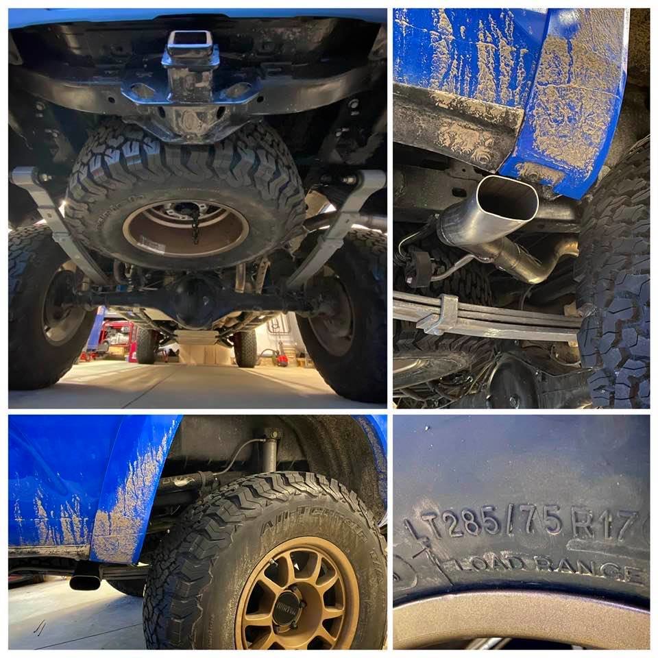

    some welding required
    old post i know but a 34 285/75/17 definitely fits at full inflation under the bed
