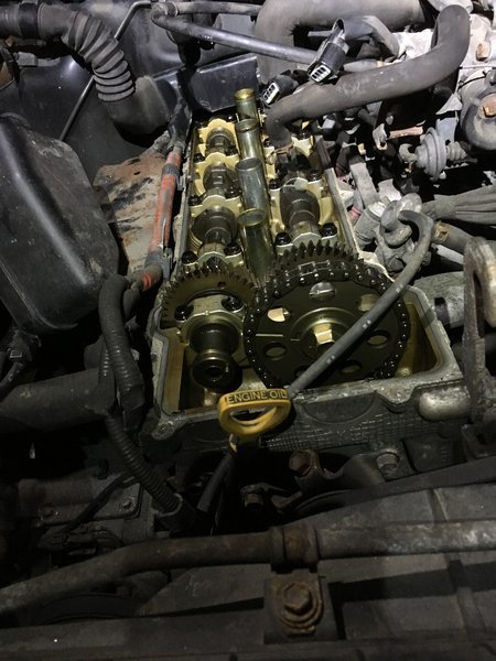

    Update: Looks like the spark plug hole was helicoiled previously. We have the valve cover off and are trying to get the spark plug tube out. Any ideas on how to do this. Can I order a new tube in the event I wreck this one pulling it out? It is just press fit in right?

    We're done and it runs great! The #2 spark plug hole had NOT been helicoiled but had been hammered oversized by the plug itself. It was a Bosch plug. We found a couple different types of plugs in the thing and have switched to Denso plugs. We ended up buying the Time-Sert tool and found it to be easy to use and well made. We did valve cover and spark plug tube seals while we were in there. Purs like a kitten. On to the next project.

    We gave up on pulling the tube out and went with the Time-Sert tool to rethread the spark plug hole. Some folks weld a longer handle on a helicoil kit to reach down into the tube.
