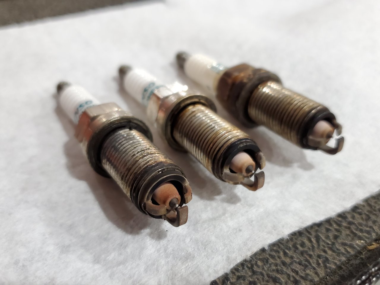

    Thanks, those don't look so bad considering. Electrodes look pretty good.

    Bad quality but...Driver side spark plugs

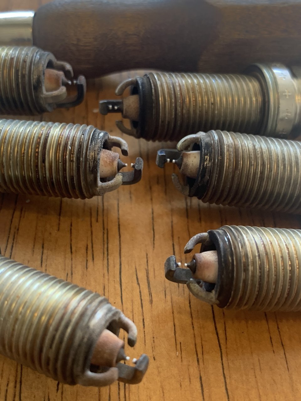

    Some of mine were exactly the same way! All of the ones on the passenger side were super easy to take out. Borderline loose. The drivers side were 100% tight. As if two techs on different sides put it together with differing meanings of the word tight.
    Just changed them at 70K. October 2015 build.
