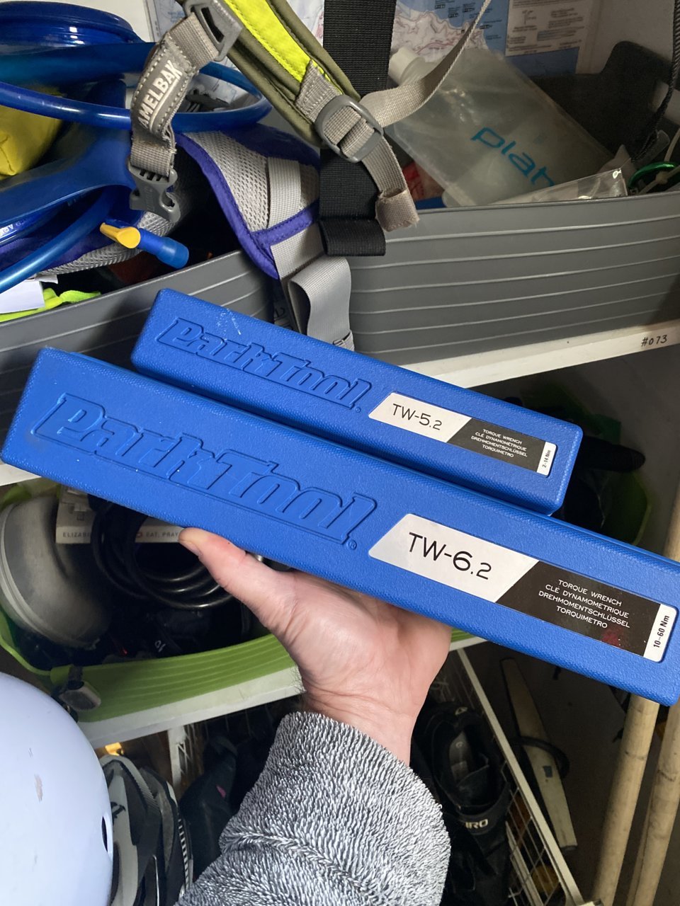

    any good recommendation for a torque wrench that's good around that torque spec? 15 pound feet if I remember correctly for Toyota

    Torque values are least accurate at the far ends of the range for a particular wrench. So use a wrench where your torque value isn’t near the high or low end if possible. If you’re going to torque to spec.

    I use park tools torque wrenches, meant for bicycles. They are perfect for the lower end torque stuff.
