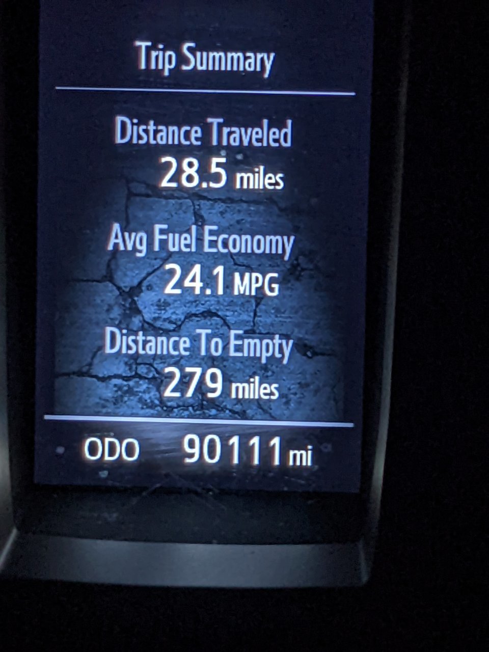

    You got some wear on your electrode and ground straps. It should still run ok.
    On the mpgs, I'd definitely confirm mileage over a few tanks.
    See my previous post about emissions equipment.

    Read my original post. Big improvement for me in a few ways. Including mpg. I have done a full tank and refill now, and went from 19.5mpg to 21.4mpg. Performance is better in all ways now. Throttle response especially on the highway is so much better. Idle is bang on now, and the truck is much quieter. Before it was pretty noisy on quick acceleration or under load up hills. Way quieter now.
    I have yet in my life to change plugs and not notice an immediate improvement.
    And no, I did not disconnect the battery. Have never done that for a plug change.
    BTW, love that Woodrow Call image. Best western book ever, and amazing original TV series when it was on. Larry McMurty rules, but sadly he passed away some years ago. Pretty much read everything he ever wrote.
