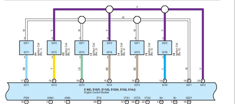

    What is that last Code on the bottom of your list? Low or high Supply voltage.....
    You need a scanner with a live data to see which cylinders misfire while idling
    Check coil connectors. Make sure the coils set all the way and tight down.
    ECU does not see a signal on the white wire
    Hopefully you did not ef'ed up ECU circuits with those experimental plugs, just coils.
    Perhaps order one OEM coil to see if it fixes the issue

    @john003, which color of the connector do you have on cylinder 3 coil ? Black or gray?

    Black
